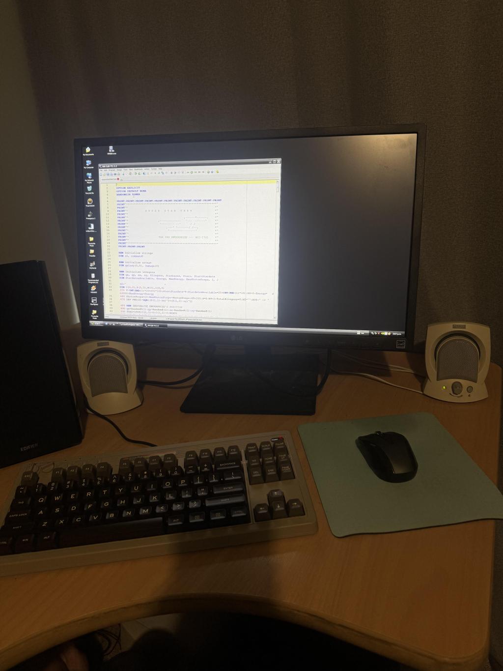

Posted: 03:10am 08 Jul 2025
Jim - Here's a screenshot of my retro setup with MMEdit 5.3.2 working
Thanks so much for your help in making this happen!
