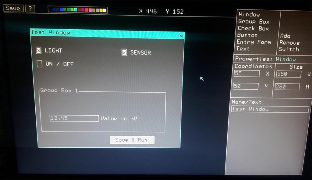

Hello all,
since I need some GUIs for my project all the time, I was tired to start every single time at zero. So I thought: "well let's SIMPLY write a program for that"... uhm.. easier thought than done. My editor is still in beta (obviously!) but as it turns out: it works really really well and saves me a lot of time.
First some pictures:
A few words on my setup (see pictures)... I often said this many times. I am not happy with the colour palette of the VGA version, since it is missing grey. On my own designed PCB I made it switchable via jumpers, so you can choose between standard picoVGA and a pseudo windows 95 16 colour palette. In another thread I posted a schematic of exactly this PCB. So I designed this editor around my "grey" mod. So if it hurts your eyes for the standard picoVGA, just change them in the code!
The second point is: At the moment it is designed for:
Resolution 720 and Mode 3... Maybe I will add more modes later on...
I use it with PS/2 mouse and keybaord. Maybe for USB you must adjust the code!
What can you do with it? Well.. At this moment in time, you can:
- create one window
- add "items":
- Checkboxes
- GroupBoxes
- Buttons
- Entry Form
- Edit its height & width and set coordinates
- Change colours of every item (foreground, background, text)
- Finally: save the whole GUI / window with mouse integration as a *.bas

At this state there is still much work to do, but since it is so helpful and time saving already I thought I share it with you, even at this state.
The GUI Editor:
gui_editor_b20.zip
Greetings
Daniel

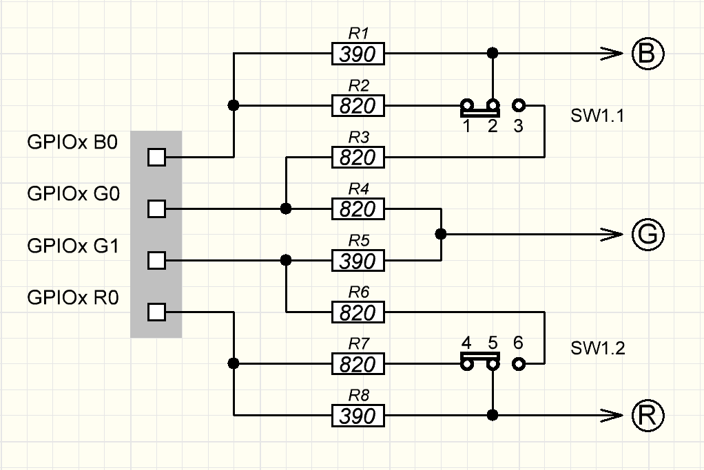

... .. I often said this many times. I am not happy with the colour palette of the VGA version, since it is missing grey. ...
Unfortunately, I don't have a VGA device. Maybe this will help or give you some ideas? I'm not sure I understand the problem correctly. For me (HDMI, mode), the example shows grayscale on the screen.
For i = 0 To 15
Map(i)=RGB(i^2,i^2,i^2)
Next
Map set
For i = 0 To 15
 Color Map(i),Map(i)
 Print i
Next
or simply "MAP GREYSCALE"?

in the VGA device it is not possible to map grey into the software, it can only be implemented via hardware tricks. There is a whole thread about this. I don't really like the HDMI version (SMD .. and I am not a fan of breakoutboards) but MAYBE I will take a look at it in near future.

Pico color management is already very complex, especially because of the different displays (HDMI, VGA, LCD).

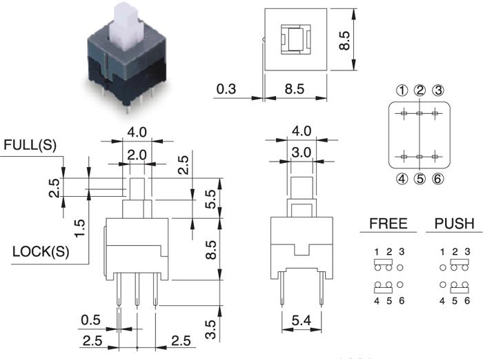

To quickly switch the color palette of the VGA121, a push-button switch can be made on the board instead of jumpers.

I also thought about that and have proper switches here, but there is no room left on my pcb to implement it without messing around with too long pcb tracks.In 99% of the time I have it set to the "Windows 16 colour palette" ... only made it switchable for others than me, who use the standard palette.

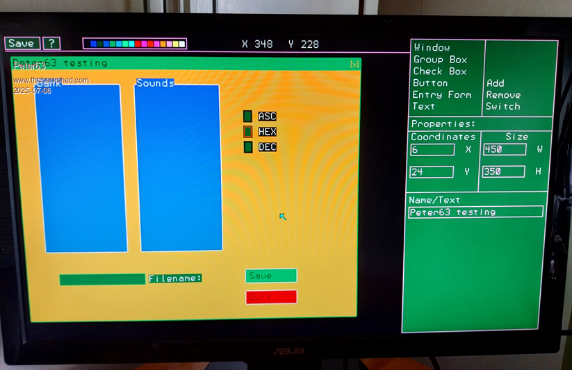

I've tested your program a bit. I've programmed a lot in Visual Basic.NET over the years, and now it's come to PicoMite...
I can only say very good work...    Hope you continue to build on this... I'll be the first to test it...
