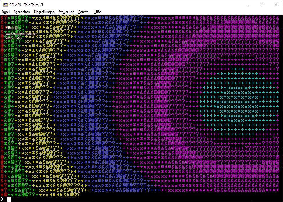

Posted: 09:59am 03 Jul 2025
Here an other type of mathematic graphics
it run on the terminal
Const ESC$ = Chr$(27)
Inc z,0.2
y = 20+(Sin(z/20)*20)
For x = 1 To 80
  a = Sin(y/2.5)-Cos(x/20)+Log(x*y)
  SetF(a*4)
Next x
Print 'crlf
Sub SetF(id integer)
 Select Case Int(id/6)
  Case 0
    Print ESC$"[30m"; 'black
  Case 1
    Print ESC$"[31m"; 'rot
  Case 2
    Print ESC$"[32m"; 'gruen
  Case 3
    Print ESC$"[33m"; 'gelb
  Case 4
    Print ESC$"[34m"; 'blau
  Case 5
    Print ESC$"[35m"; 'magenta
  Case 6
    Print ESC$"[36m"; 'cyan
  Case Else
    Print ESC$"[37m"; 'weiss
 End Select
 Select Case Int(id Mod 6)
   Case 0
     Print "+";
   Case 1
     Print "x";
   Case 2
     Print "*";
   Case 3
     Print "&";
   Case 4
     Print "@";
   Case Else
     Print "?";
 End Select
Albert
