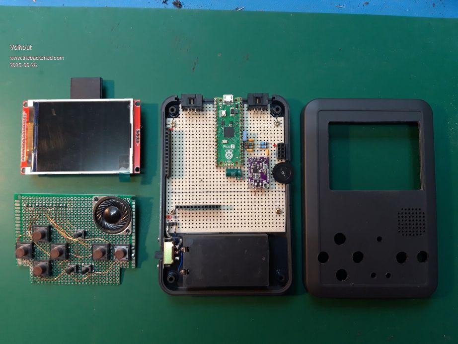

The Game*Mite was developed few years ago by BigMick and thwill. It looks like they took the original Nintendo GameBoy handy form factor as an example.
It consists of a single PCB that holds the PicoMite, LCD, buttons, audio amplifier, and battery charger... and an expansion connector.
Last year, Geoff used the idea and changed the form factor. He used the same LCD, but a different RP2040 board, charger, audio amplifier, but it is compatible with the Game*Mite. Big pro: he designed a housing. Big con: no expansion connector.
And now we have RP2350... and MMBasic 6.00.02...
Are these compatible ??
From earlier experiments I already build a Game*Mite with RP2350 (pico 2 based), besides my original Game*Mite (pico based). But I most lacked a robust housing.
I found a suitable commercial housing, but was very disappointed when I received it. It had features I did not like, was just a tiny bit too small, and had a built in battery bay.
My Motivation
I think the Game*Mite can be so much more than a Game console. There are plenty of similar game consoles for near-nothing commercially available. But here we have the golden opportunity of a development platform for all sorts of applications. I already  demonstrated a thermal camera on Game*Mite, and there is so much more.
But back to business..

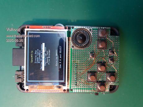

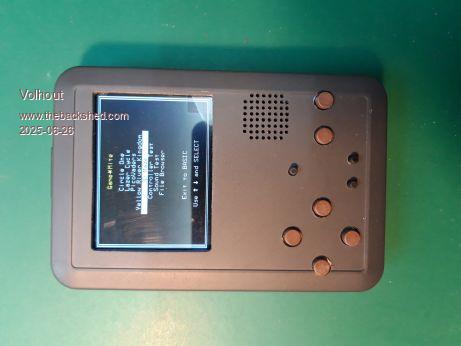

Step 1: Make a Game*Mite fit in the small robust housing. It is not too difficult. The Game*Mite consists of only few components, 3 modules (pico, charger, audio amplifier) and buttons. Just take a piece of experimenters PCB and solder few wires. Many compliments go out to Peter, who made it possible to make the SYSTEM SPI driver so robust that the wiring to SD card, LCD and TOUCH driver can be made with flying wires, no need for matched impedance traces, or good isolation. This deserves respect. Thank you Peter..
This is the result of 1 evening soldering, drilling and sanding.
Under the hood
The building blocks
Next part will explain how to put MMBasic on the Game*Mite, and will provide patched files that make the original Game*Mite software compatible with MMBasic 6.00.02.
P.S. I had to change the 14 pin expansion connector to 2x6 pins because the 14 pin would not fit. In future posts I will design everything around the original 14 pin header, as I still have my original Game*Mite RP2040 untouched.
P.P.S. as design choice I use 2xAA batteries. I do not need the charger circuit in the original Game*Mite, I connected the batteries (switch) via a P-channel FET (AO3401) according the RP pico datasheet to prevent charging of the alkaline cells.

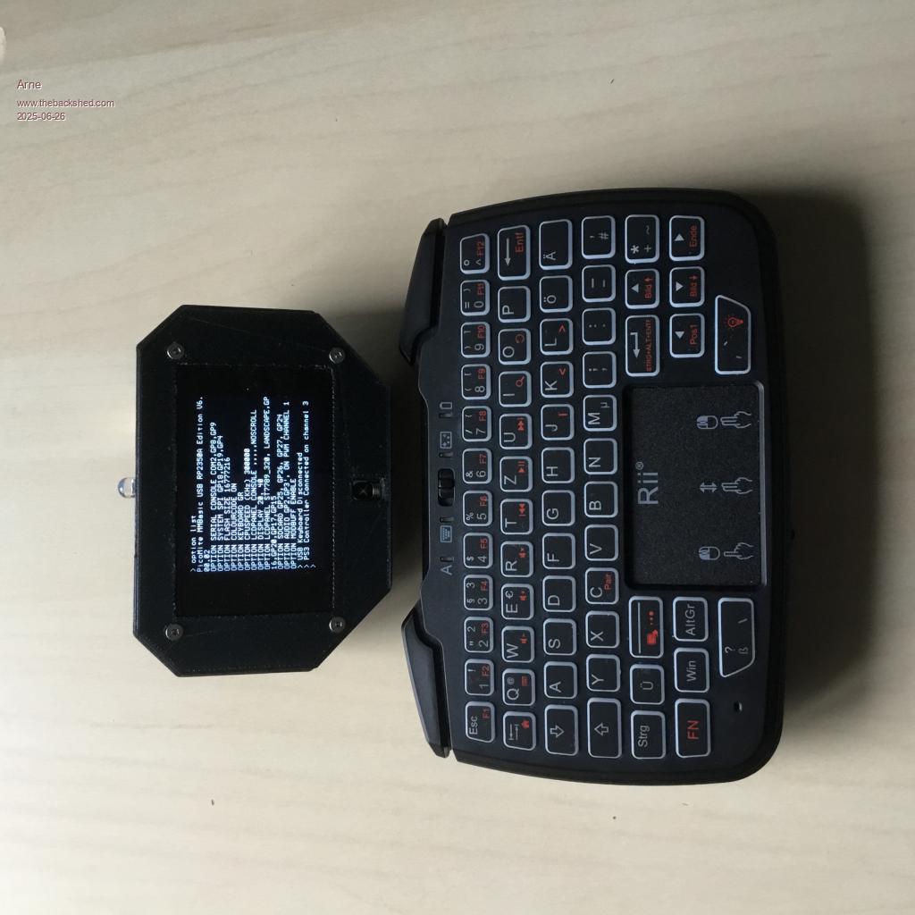

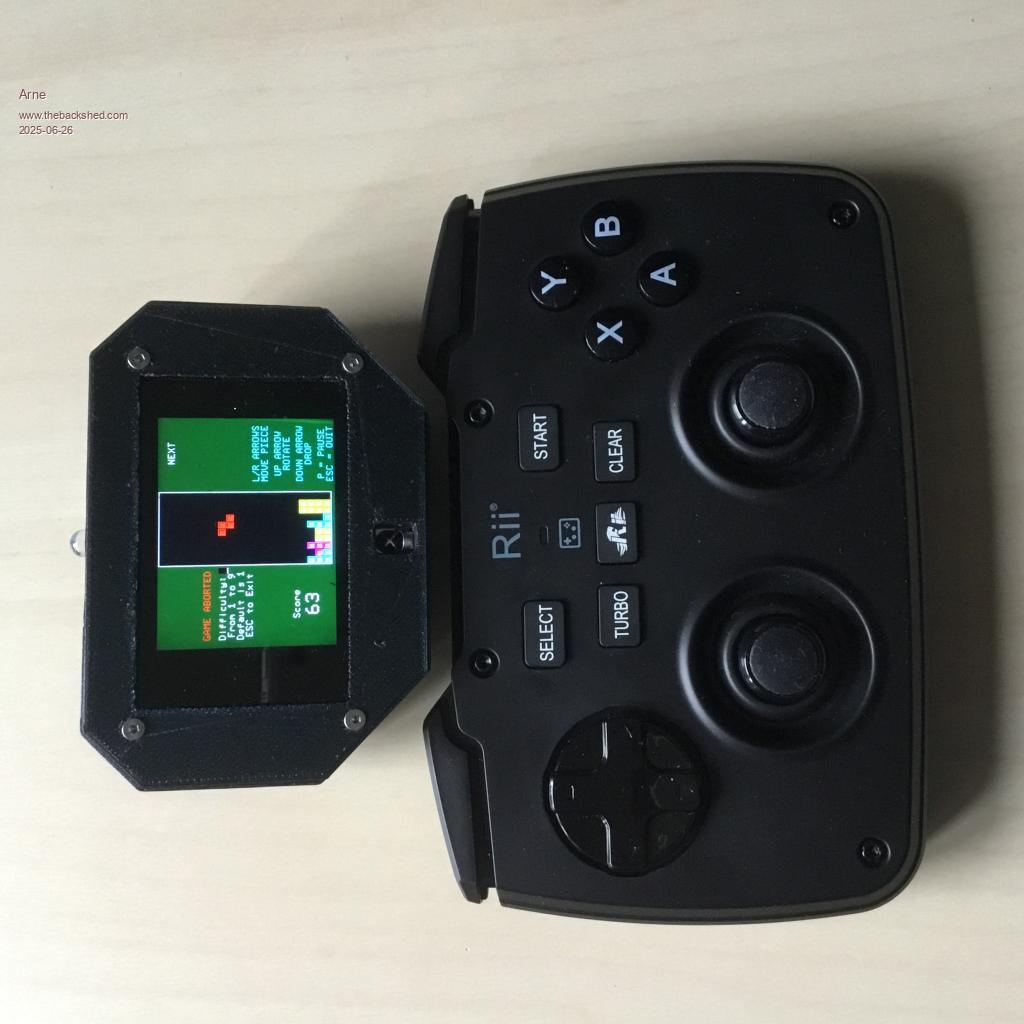

I had the Idea to build up a Picomite „Portable“.
Basically I used the Waveshare RP2350 2 inch Capacitive Touch Display Development Board, 240×320.
Due my printer does not produce good  quality it looks not very nice.
Mainly you have all relevant features you need on the board
The biggest disadvantages are that:
- sd-card slot is in the middle of the board
- the charging circuit of the board is not providing 5V to the USB-port for e.g. a keyboard.
For this a step up converter must be implemented.
Next I will try the 2.8 inch variant because it has additional  audio hardware, RTC and some other features.

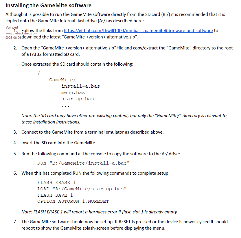

Unzip the file. Use the standard method load uf2 files on the RP pico
- first Nuke the pico (or pico2) using flash_nuke.uf2. Wait for the reboot. Note : flash_nuke works on both 2040 and 2350.
- on the pico program PicoMiteRP2040V6.00.02.uf2
- on the pico2 program PicoMiteRP2350V6.00.02.uf2
Then initialize the platform with:
OPTION RESET GameMite
For installing the software I used Tom's guide in the Game*Mite user manual. The patched software is attached here.
GameMite_1.3_60002_alternative.zip
use this procedure (you need an SD card to do this).
After reboot you should have a working Game*Mite with 6.00.02 PicoMite firmware.
Let me know if any of you run into trouble, and I'll try to help out.

  Arne said  I had the Idea to build up a Picomite „Portable“.
Arne
Nice design Arne. The display is somewhat smaller, it would give me (age) trouble reading the text. I settled on 3.2".
The Game*Mite does not need a step-up convertor, since the RP pico and pico-2 use a buck-boost converter that can boost the 3V (2xAA cell) to 3.3V. And it can deliver 300mA minimum. The audio amplifier is directly powered from 3V since it can draw high peak currents, and runs fine down to 1.8V.
Edited 2025-06-26 21:33 by Volhout

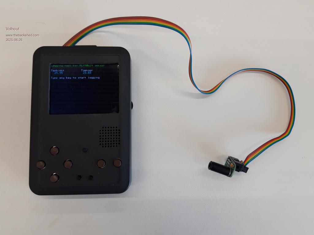

About motivation,
This is the type of application I envision for the Game*Mite when not playing games..
A logging IR temperature (this is a single pixel narrow angle camera). It is a PicoMite VGA application directly running on a Game*Mite. It needs a bit of tuning (larger font, assign a button for logging).

I've used your updated MMBasic60002.zip, putting all contents onto a SD.
I've followed steps 5 and 6 from the install instructions.
> a:

however when I run, by powering off or resetting, I get.
[92] Load Image gamemite.file$(sys.get_config$("splash", "unknown", CONFIG$)), 32, y%
Error : Could not find the file
I am currently trying to debug, but if you have any ideas?

Posted: 03:39pm 26 Jun 2025
I'm gratified to see you carrying the torch @Volhout ...
... however it looks like "GameMite_1.3_60002_alternative.zip" is missing the file "GameMite/.startup"
Sorry for not "coming out to play", real-life is getting in the way.
Edited 2025-06-27 01:47 by thwill
Bleep
Joined: 09/01/2022
Posts: 864
Posted: 03:50pm 26 Jun 2025
Hi Tom,
Yes that is it, I've also copied over .gm-menu as well, to be sure and it is now working fine :-) Thanks Tom & Harm.
Regards Kevin.

  thwill said  I'm gratified to see you carrying the torch @Volhout ...
First of all, My 2 units start up normally. And I nuked flash before I followed the install. But indeed I see no .startup file.
This will take some time, but I will come up with a solution.
Edited 2025-06-27 04:53 by Volhout

I am very sorry about this, but here is the alternative package including the .startup file. Kevin, thanks for testing. Tom, thanks for the advise (it would have taken me significant time to find this myself).
In fact: I nuked the 2350 unit, and it had the .startup file (it was in my original package). Then I fixed another bug, recreated the package, and lost the .startup file.
GameMite_1.31_60002_alternative.zip
@Tom, I modified .startup to reflect 1.3 version of the package.
P.S. Kevin, thanks to you I re-read the section on the .gm-menu.... this is great..
Tom, thanks for this jewel.
