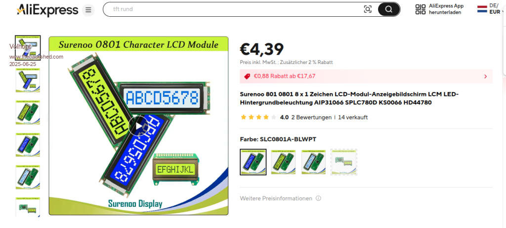

Hi,
Can't you replace the LCD with something like this.
Looks like the 6668 has a 8 numeric display.
I am convinced we could replace the 8048 with a pico, driving that display.
The pico's PIO can do the counting. All software in MMBasic.
Edited 2025-06-25 05:32 by Volhout

Very good idea, but personally I will be unable to handle the programming I am just getting too slow, think it has something to do with being 81 years old, bit disappointing but hey lets see.
I have just managed to get the battery unit removed, during taking counter out of the case I must have stirred something up.  While checking operation I turns out when pushing the ON button, display went through very quick check showing all segments and then settling down to showing all digits zero.
I will come back on the replacement displays, I would at least like to check out theoretically what would be needed.  In case it is just a new battery I need.it looks like being open circuit, the charge current then sent the voltage up to 7V 'over voltage limit' which stepped in and stopped operation.
