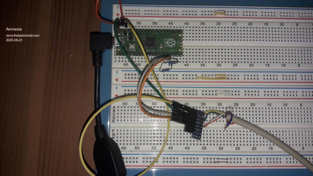

Hello,
is it normal that ALL USB-versions of the PicoMite firmware have missing characters / slow response if typing "fast"?
I already tested this on previous versions (now I switched to the latest release) and thought "well it probably is fixable by setting the options for repeat rate and so on..." but this doesn't cure the problem. For me the USB-version of the firmware isn't usable at all. I can't force myself to type slow. In another thread I tested some recomandations for repeat rate etc. but none of this helped. USB seems to be too slow.
Is there any solution with a second Pico acting as a USB-to-PS/2 converter? I am aware of the ps2x2pico solution by the user "No0ne" (https://github.com/No0ne/ps2x2pico)
but this doesn't work at all - especially I need a German layout...
Greetings
Daniel

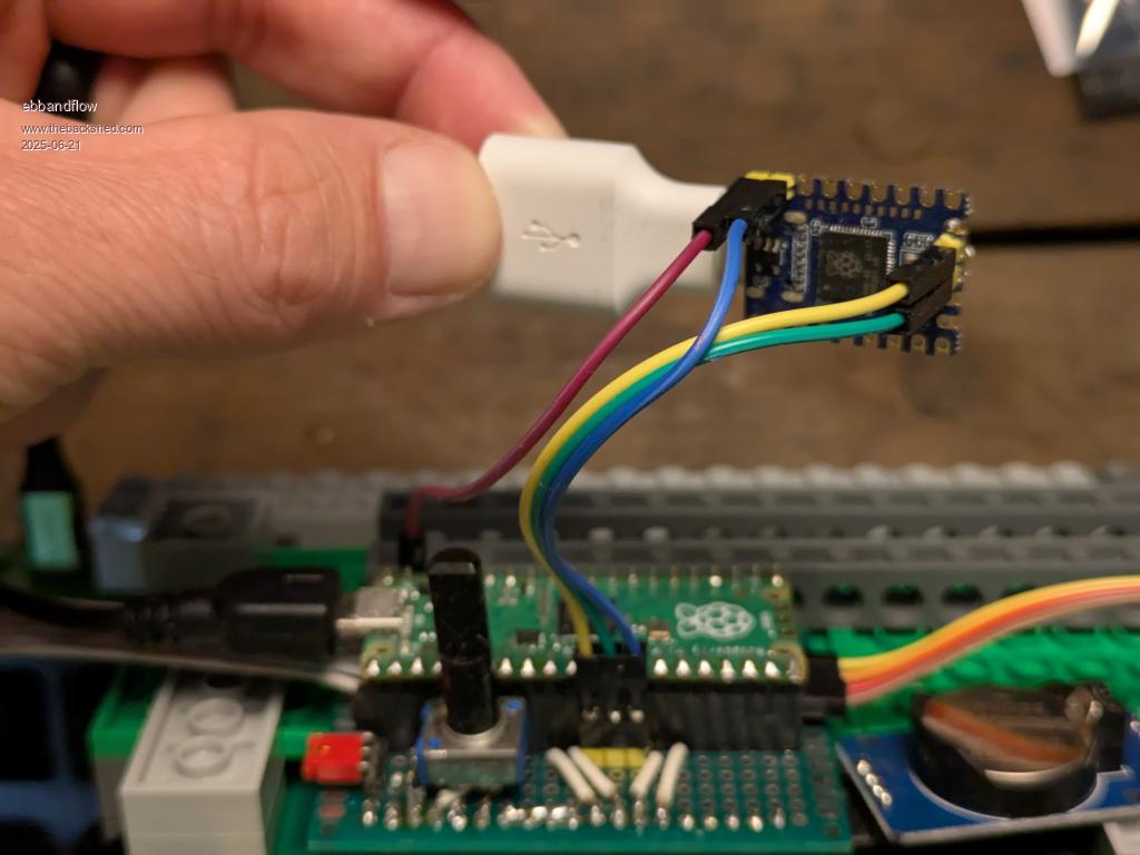

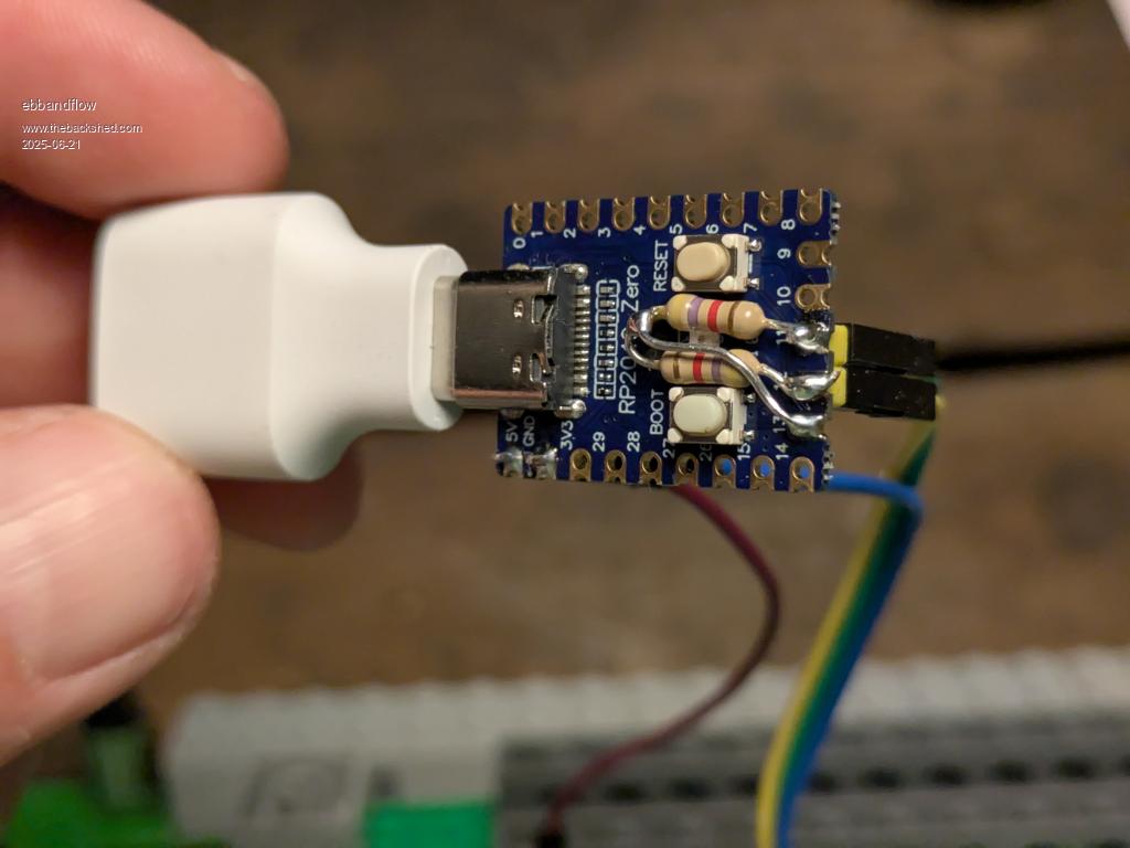

ebbandflow
Joined: 31/08/2023
Posts: 59
Posted: 03:51am 21 Jun 2025
Hi Daniel, I struggled with the same issue and ended up having luck with ps2x2pico and an american keyboard layout and posted about in the last post here
"RE: my input speed issues, I ended up making a USB -> PS2 converter from an extra RP2040 Zero flashed with the ps2x2pico firmware. I skipped the level converter shown in the github and instead added a 4.7k pullup resistor from GP 13 to GP11 (PS2 Data) and GP 13 to GP12 (PS2 Clock), and then connecting those to the picomite and linking VBUS between the two picos as well as GND. Now I can use a USB keyboard with the input speed of a PS2."

Amnesie
Joined: 30/06/2020
Posts: 763
Posted: 09:02am 21 Jun 2025
Hello ebbandflow, hi all!
Can't thank you enough. It works! I previously tried the approach with the ps2x2pico by the user "NoOne" but it didn't worked because I thought I don't need the pullup from GP13 and left those out - mistake! With your suggestion of two 4k7 to CLK & DATA it works perfectly.
But I have a question to all:
Why the heck does it work with my GERMAN keyboard layout ???? I am not complaining at all, I am suprised and thankful that it works, but I have no clue why it works! Maybe anybody can explain this to me?
I am using the PicoMiteVGA (ps/2 version) with this USB to PS/2 converter by NoOne (ps2x2pico firmware). This firmware - as far as I know doesn't have german layout like his other version ("hid2cdc" firmware) in which you can:
"GPIO6 jumper to GND for QWERTZ keyboard support"
so the question for me is: why does ALL of my german keyboard layout work with this firmware? Is there some "autodetection via usb"? Of course my keyboard layout for MMBASIC is set to german, but how does the "ps2x2pico" firmware know that I am using a german USB keyboard? Just want to udnerstand what is going on.

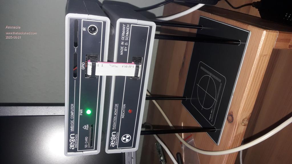

So GREAT NEWS for all German users here which find the USB version too slow. Just use the PS/2 firmware und use this converter! I tried 5 different german keyboards, all work perfectly.
Ha! Now my Geiger-Counter has both: USB AND PS/2
Greetings
Daniel

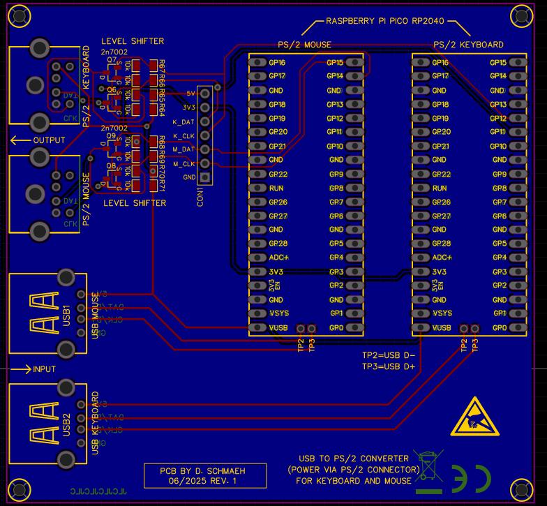

Amnesie
Joined: 30/06/2020
Posts: 763
Posted: 05:37pm 21 Jun 2025
Hi all,
I decided to do a seperate PCB. I don't like the USB-HUB idea for three reasons:
1. there were already problems with counterfeit ICs
2. USB dongle-li-di blah blah (too much connector cables)
3. I am in the need for a specialized HUB ICs and have no clue about its availability / obsolesence plan
So let's just take two Picos. Why? Prices for a Pico are a joke, especially the needed RP2040. And even if you go the HUB-IC route; this is an IC, too. Ok you can get those ICs for 1 dollar / euro.. But if I socket my Picos I can do way more with them, since they are not specialized and can be re-programmed.
Another benefit is, that there is no cable salat anymore   There is only one downside (if one cares) and that is space. For me this isn't a problem.
For me this approach is far superior to the PicoMite USB variants. If one types fast, there is no option around it, I think - unless Peter could speed up things. But I guess there are limits. I have no clue about this...
A HUGE benefit is also, that there is no need for a USB variant anymore, you can even  use USB and PS/2 "at the same time" - I mean without re-flashing the firmware - how cool is that?!
If there is interest I will publish the gerbers, for now I have to get them made for me, if they arrive I will report back if everything works fine.
"CON1" on my PCB is only for measurements / optional...
Greetings
Daniel
Edited 2025-06-22 03:54 by Amnesie
ebbandflow
Joined: 31/08/2023
Posts: 59
Posted: 06:10pm 21 Jun 2025
If using the ps2x2pico firmware, wouldn't you want to control (the HV side of) the level shifters with gp13's as shown in the github 'schematic'? Otherwise you'll face the same problem you had when not using pullups to gp13. I like the idea of putting this in a tidy little converter board, it's a good plan.
Edit:
Also, for greater compatibility w/ existing picomites in the wild, what about adding some jumpers and locations to populate pullups to bypass the level shifting and allow for the circumstance of only needing to directly connect to another Picomite that does not expect 5v level signals?
Edited 2025-06-22 04:24 by ebbandflow

Amnesie
Joined: 30/06/2020
Posts: 763
Posted: 06:28pm 21 Jun 2025
  ebbandflow said  If using the ps2x2pico firmware, wouldn't you want to control the level shifters with gp13's as shown in the github 'schematic'? Otherwise you'll face the same problem you had when not using pullups to gp13. I like the idea of putting this in a tidy little converter board, it's a good plan.
Good that you ask, because I forgot to mention this! Your 4k7 pullups are not needed here because there is already a level shifter (to the upper left on the PCB).
I don't use GP13 in both cases, because GP13 is only a "DOUT" set to HIGH, that means this pin only delivers 3,3 volts. If you look carefully on the PCB (I know the resolution is bad) you can see that I am using the 3v3 Pin on the Pico itself going to my level shifter. So I am doing the same here, only direcly via the 3v3 pin from the pico through the level shifter.
I am almost certain why "NoOne" (the designer of this cool firmware) chose GP13 for this, instead of the original 3v3 pin on the pico. That's just because he used a ready made level shifter you can buy online everywhere - which dictaded the pinout. And to match the pinout of the level shifter he utilized GP13 for this.
Long story short: not needed, I doing it already.
Greetings
Daniel
