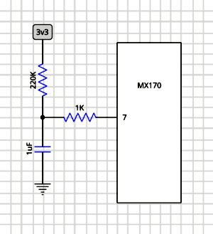

Posted: 01:08pm 15 Jun 2025
success, using an external RC as suggested by Mixtel90, using just a single pin:
and the following code:

i've also been able to verify that CPU SLEEP does not have any effect on the timing.
