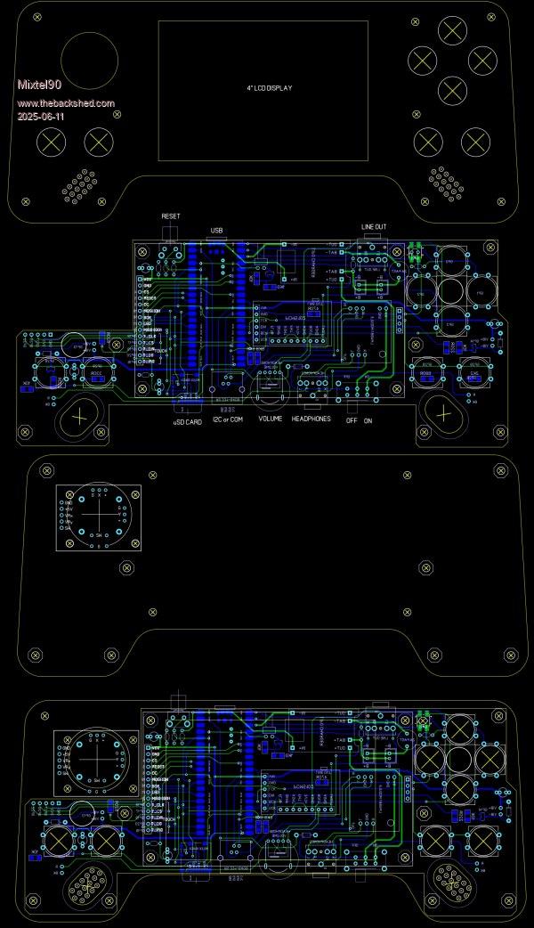

Is it worth continuing with this? I think I can make the hardware work, but would the 4" SPI display update fast enough for games? The processor is the Pico 2.
The front and rear are acrylic, linked by spacers. The lower 4 buttons are all on GP28, but one is a direct switch to GND so by reconfiguring GP28 to digital it can be read as fast as any of the others. There is an analogue joystick on the left and I have had one of these also acting as a switched joystick so you get the best of both worlds!
Not Game*Mite compatible and I'm not intending to compete with that. This is just an exercise to see what I can do with the concept. No schematic yet, it's all in my head. :)

The 4" ST7796S is faster than the ILI9488 as it uses 16 bits/pixel rather than 24.
In portrait mode it has hardware scrolling that is quite fast.
For a game that has a lot of horizontal movement the panel could be sideways and the game written as if everything was on a wall rather than the floor.
Peter was quite impressed by it.

I don't fancy the square display for this. I don't think that any of the games so far have suffered too much from the speed of the ILI9341 (I don't know about the ILI9488, I've never had one). They are all too fast for me anyway! The ST7796S gives a very useful increase in screen size though (if anyone will use it!).

I think a 480x320 display is the wrong approach. Most Pico Game development is done for 320x240. This could be windowed onto a 480x320 display but the image would then be smaller than a 2.8" ILI9341.
This is why my PicoCalc clone uses a 320x320 display. With this windowing is trivial and you get the full width. It also runs in portrait mode so you get H/W vertical scrolling.
The other comment I would make is the need to be able to connect a keyboard. The success of the PicoCalc, such as it is, is that is completely self contained you can program directly on it.
To me this is the USP. There are a gazillion cheap handheld consoles out there with much better games libraries than MMBasic on the Pico.Being able to program direct on the device is what differentiates the PicoCalc.
Your form factor is nice and I did design something similar ages ago but never had one made but at the end of the day it is just a Game*Mite variant so why not stick with the original which has some level of S/W support.
If you wanted to proceed my advice, FWIW, would be as follows:
Use the same 320x320 ST7796S display as on my putative PicoCalc. You will need a 40-pin FFC breakout to connect it and a cheap boost converter (less than USD 4 for the pair).
Add a PS2 keyboard connector or go the whole hog and run the PicoMite USB firmware in which case you will need a USB/UART for the console.
Standardise on the Pimoroni Pico plus 2 as the processor module so that PSRAM is always available.
Then you might have something with a reason to exist as a nextgen Game*Mite

There isn't really a place for something in addition to the Game*Mite really, I was giving it a go just to see what could be done and I thought a good place to start would be as big a display as I could reasonably get - I really don't like squinting at small displays much. However, the hardware is only as good as the software available and there isn't any for that display resolution. Unless this concept captured the imagination of the games writers (and my programming abilities are c**p) there's no point to it.
Nope, I'm not going to carry on with this, although it's been fun. :)

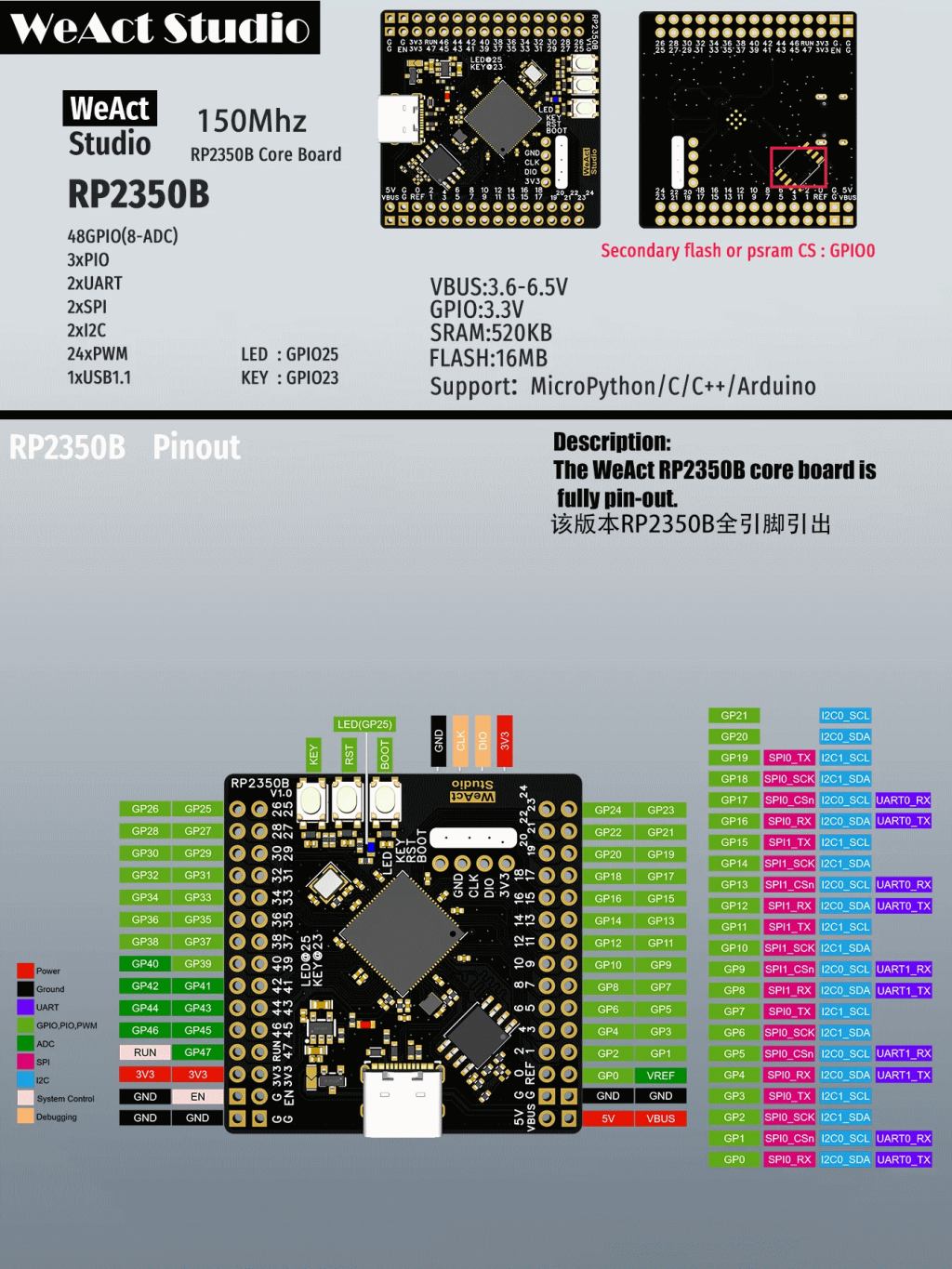

  matherp said  Standardise on the Pimoroni Pico plus 2 as the processor module so that PSRAM is always available.
What do you think about the inexpensive WeAct RP2350B module?
https://www.aliexpress.com/item/1005008404804398.html

TBH I personally wouldn't standardise on any module not made by RPi. They know how it all works. They wrote the spec. They provided the Datasheet. They have the leverage to get modules made properly, whether it is Wales or China or wherever - even if it means sending whole batches back for rework. I tried the PGA2350 and I rather like it, but it's still something I'd play with rather than base a proper design on. If someone wants to plug in a pin-compatible clone then that's up to them, but I'd build and test to a Raspberry Pi board. That means I can't have PSRAM at the moment. Too bad, but it's simply not going to happen at the moment.
