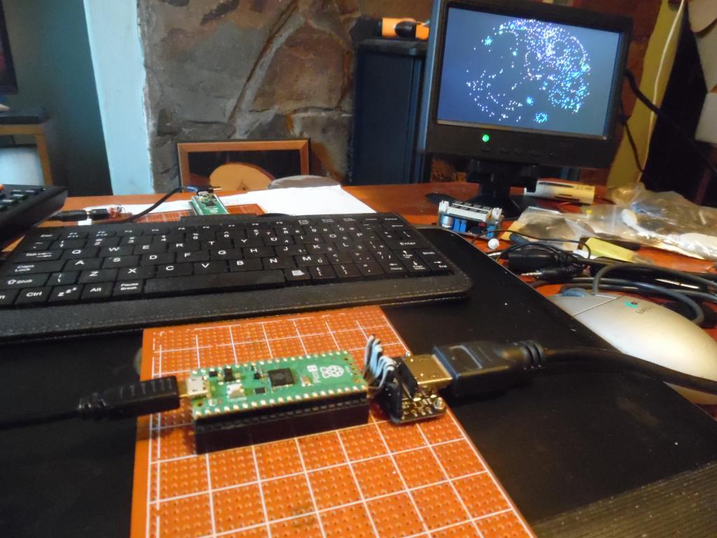

ok the first try which I tested with molex type male to female, The idea was wires under the board but just testing and isn't it amazing you can use molex like this to test and it works.  bubble universe running
it's not a bad dvi board Mick. I just want more people to use mmbhasic but not get cocky or it get rocky

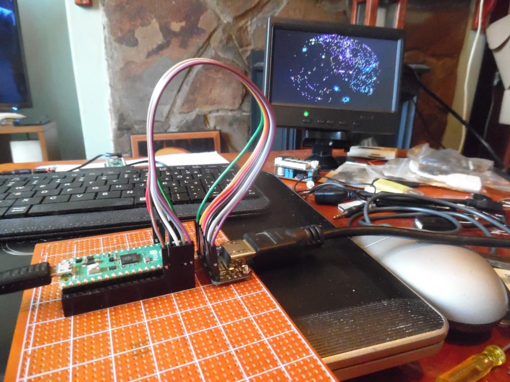

Posted: 07:44pm 12 Jun 2025
it looks tidier than before but not fun wiring/ add usb to ttl and sd card reader next.
no joining links between strip board tracks yet.

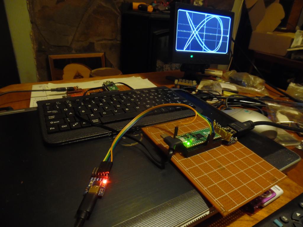

I flashed the hdmi usb and temp wired a usb c to ttl and used the 5V to power pico pin 40 vbus. I got a usb keyboard connected that's uk but always start with mum lock on and  always types daft chars.
got to do the micro sd card next to get "the complete kit :("
got a few sd card readers, latest 3V so use pico 3.3V out or usb to ttl 3v out?

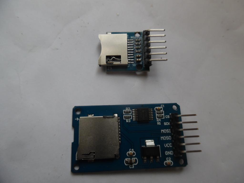

2 sd  card readers, one looks passive and meeds 3.3V, the other looks like it got a reg so probably needs 5V
never had problems with sd card readers before. used the manual suggested settings

The top module will work. The bottom one might work, might not or might be touch and go, depending. :)  It's intended for a 5V supply. The voltage regulator won't regulate if you power it at 3V3 (not enough voltage across it) and the level shifter might be marginal because of that.
All SD cards are 3V3. They work fine when fed from the Pico. You can probably use the socket in the bottom picture by powering it from 5V rather than 3V3. Take the supply from VSYS.
For testing purposes you can use any GPIO pins for a SD card providing you specify them all in OPTION SDCARD.

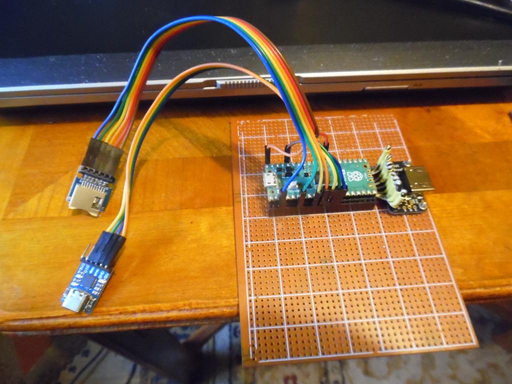

got this from passive card reader so think it's ok... now to wire it as all this was test wiring then audio out, yawn

this was with "the top one" Mick but I gonna try the 5 V? card cos I used them dim problemo... just to test. it was initially an easy diy plan but take it back it's not easy.
soldering is worse than smoking
