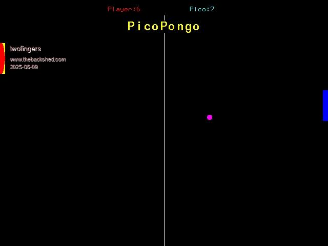

This is PicoPongo, my version of Pong for Picomites.
The HDMI (Mode 3) game is designed for solo players against the Pico and keyboard control.
Help key is 'F1'.
Cursor up = Paddle up
Cursor down = Paddle down
't' = Sound on/off
's' = Screenshot
'p' = Pause
Esc = Exit
Have fun.

Something wrong here. The ball isn't square. :)

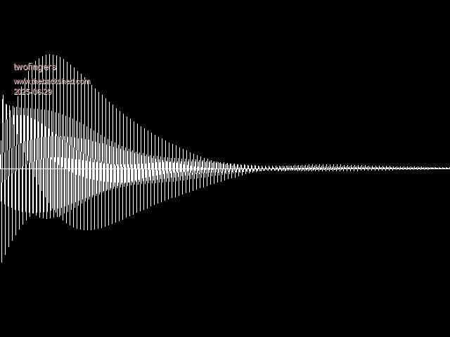

I didn't expect I'd have to get into synthesizer building to develop this game (envelopes, ADSR, beating). I'm surprised it's so easy with our PicoMite (after all).
I was able to learn a lot about the intricacies of the "PLAY LOAD SOUND" command for user-configured sounds. Unfortunately, the command is poorly documented. But ultimately, it is possible to play very different samples with this command.
The sounds used were calculated by the Pico itself and then saved as DATA lines. They often displayed beautiful diagrams like this one.
