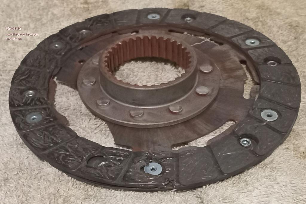

Ouch....this is not good....
No problems, right? (rhetorical!)
This was a NEW clutch plate, installed about two weeks ago.
Car is an MG 1100, '64 vintage, but basically uses the exact same clutch arrangement as the classic Mini, Allegro, Metro, and all of the classic 1100/1300 cars.
So, what went wrong here?
The clutch plate was replaced, along with the primary-gear.

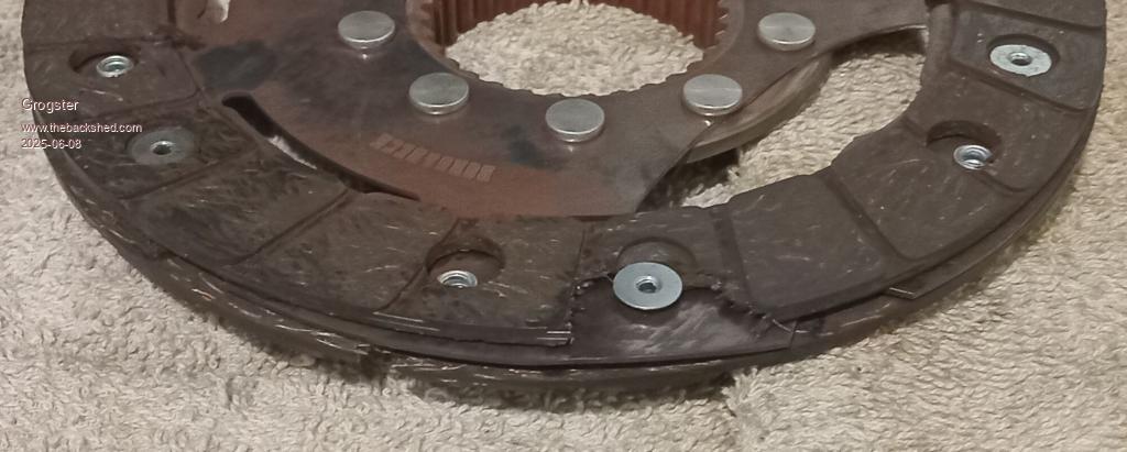

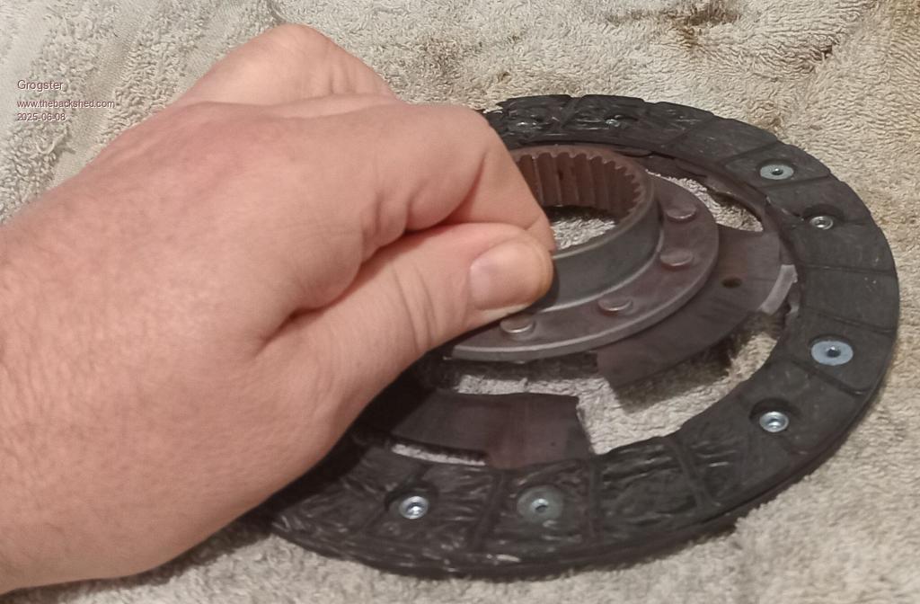

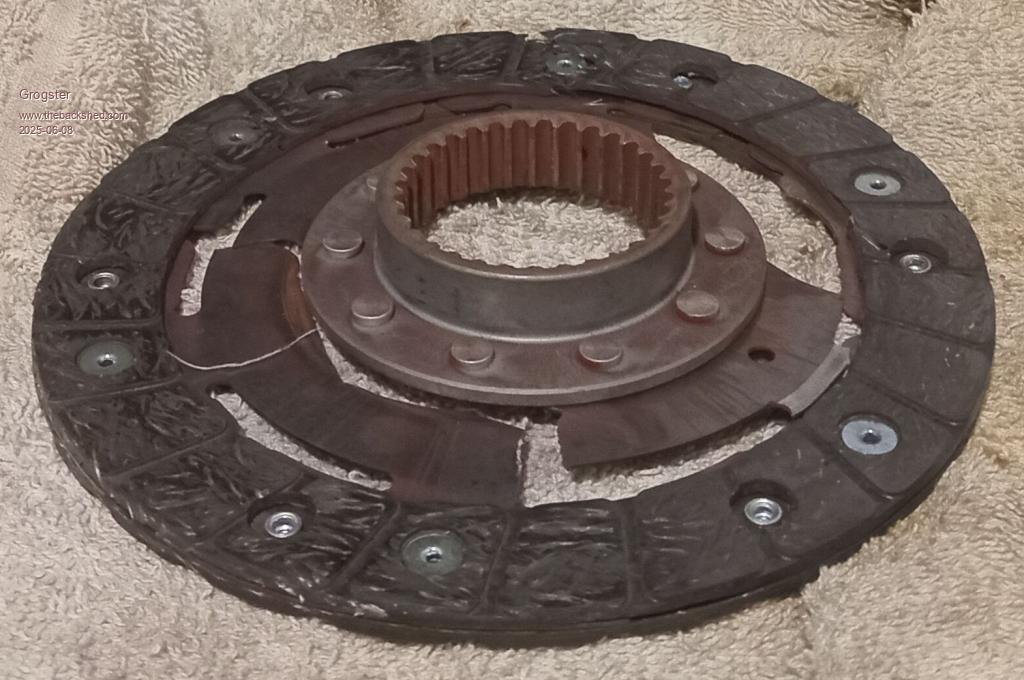

Two weeks later, this was the result.
When the car was examined a bit more in detail(after this failure), it was found that the crankshaft end-float was around 8mm or so.  Ahhhhh......NOT good.  This means that the crank can move laterally on the main-bearings, by up to 8mm in either direction.  I don't expect there is much left of the center-main thrust washers...
But this then allowed the crank to move drastically along the inner of the primary gear, destroying both the new clutch plate, new rear-main-seal, and the primary gear inner bearings.  The primary gear itself, seems fine, but the bush bearings are chewed up inside.  I still think we can re-bush the primary gear and save that, but.....
This is not good.
Will need a full engine rebuild to fix this.

  Quote  This is not good.
Yes, the plate's flex-disc can only cope with a very small misalignment.
