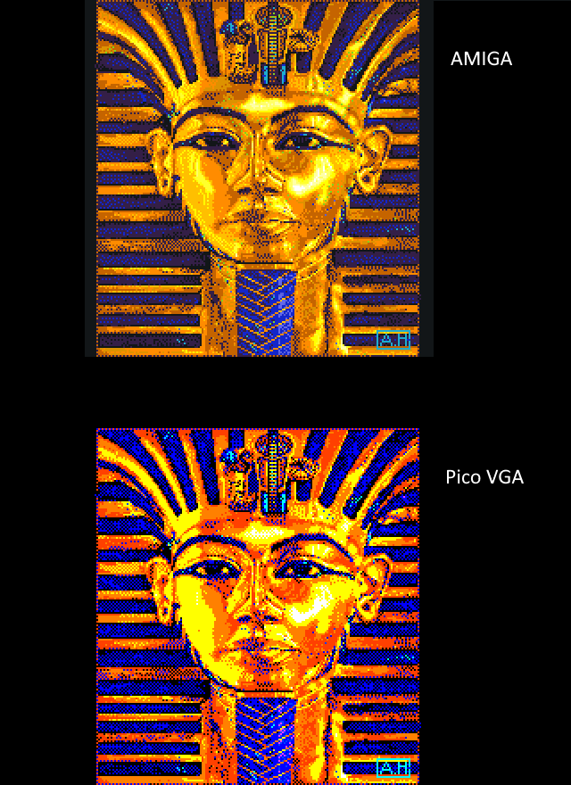

In that post you showed an illustration from a PicoMite(VGA?) that had been modified to allow grey in the palette though you never posted a schematic ?

You can get grey with a RGBI network, though for maximum compatibility with Pico VGA RGIB is better. RGIB resistors
For image conversion I used a Pico LCD and a program (in the link above) to distort the colours so they would decode correctly through the RGB121 codec in the Pico VGA.

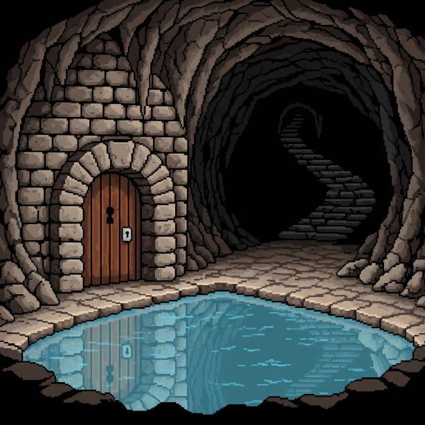

I asked Google Gemini:
Generate an image of a cave with a stone stairway on the left-hand side and a wooden door in an archway on the right-hand side.
'no comment
Posts: 4394
Posted: 03:01pm 07 Jun 2025
It is amazing isn't it.
I thought I didn't have access to Gemini image generation in the UK (or for that matter in Europe), but apparently we do.
However, it still does what it likes:

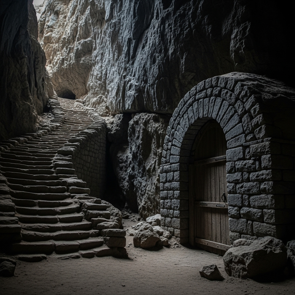

  Quote  Generate me an image. The image should be in a pixel art style 240 x 160 pixels. The image should use the default EGA palette. The image is of a cave. The floor of the cave is covered by a pool of water. In the left wall of the cave is a stone archway containing a brown wooden door with a keyhole. At the back of the cave a stone stairway winds up into the darkness.
Not the default EGA palette, not 240 x 160 pixels, or even in the correct aspect ratio.
However still amazing, if frustrating (I find trying to get consistent style is especially problematic) ...
... and maybe by feeding this image into ChatGPT I can get it to produce the image I really want.

Posted: 04:21pm 07 Jun 2025
Me:unfortunately wrong again, please check the resolution and color depth again
Gemini:
  Quote  I apologize, but I am unable to guarantee the exact 320x160 pixel resolution and adherence to the precise EGA color palette with the image generation app. I have attempted to generate the image as closely as possible to your specifications, but the tool does not allow for such fine-grained control.
'no comment

  Quote  In that post you showed an illustration from a PicoMite(VGA?) that had been modified to allow grey in the palette though you never posted a schematic ?
Link to a schematic in my previous post.

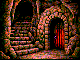

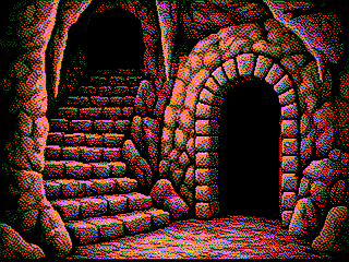

  Mixtel90 said  I can't see anything wrong in that. In fact, the walls and floor were surfaces that could be coloured. The door archways were polygons that were drawn over them, with the doors as further polygons inside them, covering the black area.
so from this
to this
Edited 2025-06-08 19:26 by Martin H.

Martin H.
Joined: 04/06/2022
Posts: 1519
Posted: 09:50am 08 Jun 2025
  Volhout said
Martin: that is not PicomitVga color palette.
sure it is
'no comment
