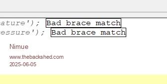

Edit 2:  Also, "Bad brace match"
Appreciate all these are from hitting it with JS code - not moaning -- offering to see if I can fix it as this is so useful in my workflow.

  Quote  Edit 2:  Also, "Bad brace match"
File/Preferences untick "Warn about unmatched bracket"
