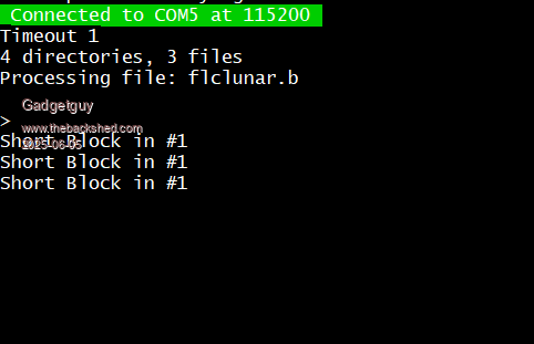

So for example I cannot copy a basic file from the picocalc to my PC, as the file commander copies the wrong file name (the file is called myprogram.bas - file commander tries to copy myprogram.b" which then of course fails as there is not myprogram.b)
I tried several other features - nothing works.

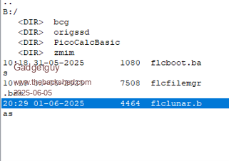

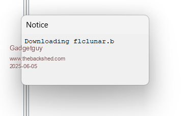

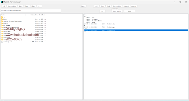

Not sure how to attach screenshots to show that in the Maximite File Commander in the folder view it seems that the folder view picks up only 40 characters in a row (exactly like on the Picocalc screen) - as a result the file name is in two lines. The first line (40 chars) is "filename.b" and the following line has "as"
Then, when I click on copy (using the <<< button) it picks up only the text from the first line "filename.b" - which then of course does not work.
So - how can I see more than 40 characters on the File Commander Screen, or how can I tell to File Commander  to take the full file name (which is actually in two lines in my case)
