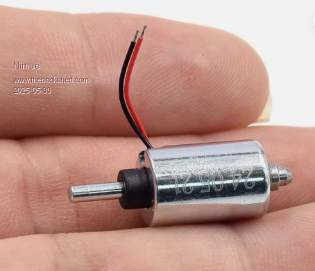

I am looking to make a handheld device that pushes a "stylus" at no more than 5Hz for a couple of seconds.  As this needs to be handheld, I was looking at mini solenoids.
As I understand it, something like this:
should do the trick.
It needs 7-12V to drive it.  But, my granted limited, understanding of these is that current is the more essential component - possibly 500mA - 1A.
To drive this I assume I need a transistor and separate power supply for the solenoid.
My questions:
(1) Is operating a solenoid like this on-off-on etc at 5Hz going to kill it?
(2) Is there an alternative to generate in-out motion available (without gears to change rotary to linear -- due to my size constraints)?
(3) My use of a Pico (probably a Zero) would be to have selectable frequencies and duty cycles of the solenoid (but appreciate there are non microcontroller ways to do this)  (0.2s push, release, 0.3s push kind of thing)
Think something the size of an electric toothbrush -- ideally battery powered (9V?).
The "push" cycle needs to have some force - 50-60g of pressure (roughly the same as to activate a mechanical keyboard).

Solenoid is a great way to go and no, you won't kill it.
Is it energize-push and spring-return?
I have done some neat things with solenoid valves where I used half a H-bridge to drive them.

Pretty sure that PWM into a ULN2003 would more than handle it.
Posts: 9081
Posted: 02:58pm 30 May 2025
If it's spring return then it's possible to control it using PWM. If the frequency is fairly high it will be quite smooth. However, it won't be linear because springs aren't linear. As an output stage from a Pico I'd use a 270R series resistor and a 10K pull down resistor into the gate of a N-channel MOSFET such as a IRF540. This has a very low "on" resistance and a high surge current. Probably a bit overkill but cheap. :)  You'll need a diode across the solenoid as if it was a relay. It has a similar sort of back-EMF.
Note - if the PWM frequency is below 10kHz or so you might hear it "sing". :)

It needs to fit in a toothbrush size housing. It needs 7 to 12v to drive the solenoid. Yes, peak currents can be 1A. So i would suggest 2 small lipo cells in series=8v. Then a logic level fet that can handle 2A minimum, directly driven from a pico. Don,t forget the flyback diode. In the final application, that is quite simple, you could use  attiny45. I know peter ported mmbasic to it, and it is smaller than a zero.
5hz can be done on such solenoid, but not with 5mm swing. It all depends on the mass you add to the moving part of the solenoid. Simple math, energy avalable, efficiency of electromagnet, mass to be moved over what velocity.
I would start with the esseentials. Can the solenoid, spring return, generate 50 gram force in the application. When not, you need to push pull drive it. There are small push pull drivers for these powers, like used for printers, where they control paper feed motors.

IRF540
You need a logic level FET. Choose one starting IRL
   IRLZ44N, IRL540N, IRL530N :: older parts ("L" in means logic-level, "F" parts have 10V gates)
   IRLB8314, IRLB8721, IRLB4132, IRLB8748, IRLB8743, IRLB3813, IRLB4030, IRL2203, STP105N3LL, FQP30N06L, RX3G07CGN :: newer part numbers

Nimue
Joined: 06/08/2020
Posts: 449
Posted: 11:53am 31 May 2025
  matherp said  IRF540
   IRLZ44N
Perfect - was going to start with TIP120 as I have a few to hand - but on looking the heat dissipation managed to find a friend with IRLZ44N on hand, so will switch to that.
Couple of days for the solenoid to arrive and will prototype.  Assuming it works
Thanks all.
Use case:  am working with a local manufacturing company on a set of industrial keyboards they use in their plant - but the units are "sealed" due to the dust ingress. The dust tends to be rubber particles, often with carbon added - so possibly slightly conductive. The manufacturer resists my request to take the keyboard out for cleaning - and insist on a cost prohibitive rebuild -- plus it puts the machine out of action as there is no option for alternative keyboard.
Blasting round the failing key with air works temporarily - but the best solution seems to be contact cleaner and manually pressing the keys repeatedly.   Keys "fixed" like this seem to then continue to work.  So the idea is to make a handheld gizmo that pushes the keys without manually banging them - in theory allowing the whole keyboard to be cleaned quicker and more finger friendly than manually.
