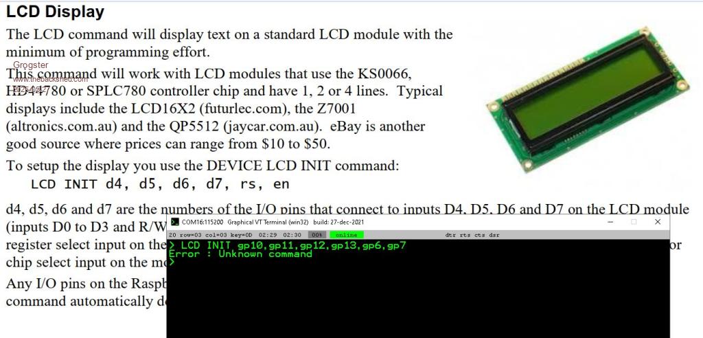

Confusing syntax and example for using a classic 16x2 or 16x4 LCD module, page 52:
You will see exactly where I went wrong, but the example does NOT include the "DEVICE" keyword, so my attempt was rejected.
Posts: 10074
Posted: 07:09am 27 May 2025
....and the following page on how you write to the LCD module, is also generating unknown command errors.
Perhaps I am the only one on Earth now, trying to use these old legacy LCD modules.
EDIT:  DEVICE LCD command fixes this issue, as you might expect, but I think the manual needs a tweak here.

No, you are not the only one.
But I failed to send a user manual correction to Geoff.
The new 6.00.02rc24 supports both (just tested)
- DEVICE LCD INIT a,b,c,d,e,f (legacy 5.08.00)
- LCD INIT a,b,c,d,e,f (legacy micromite)

The DEVICE was a temporary solution.
MMBasic used a tokenizing scheme that allowed for 128 commands and 128 functions.
During the development of PicoMite so much functionality was added that 128 was not enough. The DEVICE command/function was added to group a set of peripherals.
DEVICE HUMID
DEVICE LCD
DEVICE WS2812
etc...
To free up slots for other commands.
Then (between 5.08 and 5.09) the functions changed from 8 bit to 16 bit.
And between 5.09 and 6.00 the commands changed from 8 bit to 16 bit.
So in 6.00.02 we have no limit on 128 anymore and the DEVICE was obsolete. But for compatibility for programs developed between 5.08 and 6.00 (I assume) DEVICE is still maintained as alternative.
Apparently the user manual was in a between state...
That should sum it up.
P.S. for a while DEVICE was called BITBANG
