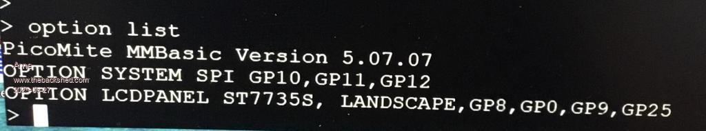

So, can you CONFIRM that the controller on these WS modules, is the ST3375S?

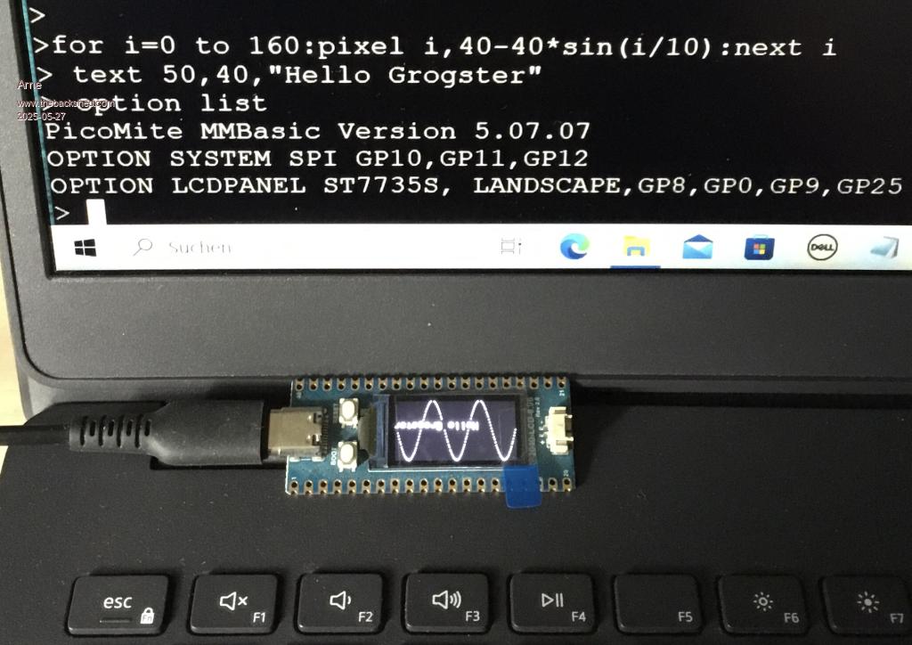

Posted: 08:00am 27 May 2025
With my configuration it is working.

Better is:
OPTION SYSTEM SPI GP10,GP11,GP28
OPTION LCDPANEL ST7735S, L,GP8,GP12,GP9,GP25

So....the controller chip is an ST7735S, yes?
And it is supported?
That is what I want to know, before I buy any of the WS modules....
