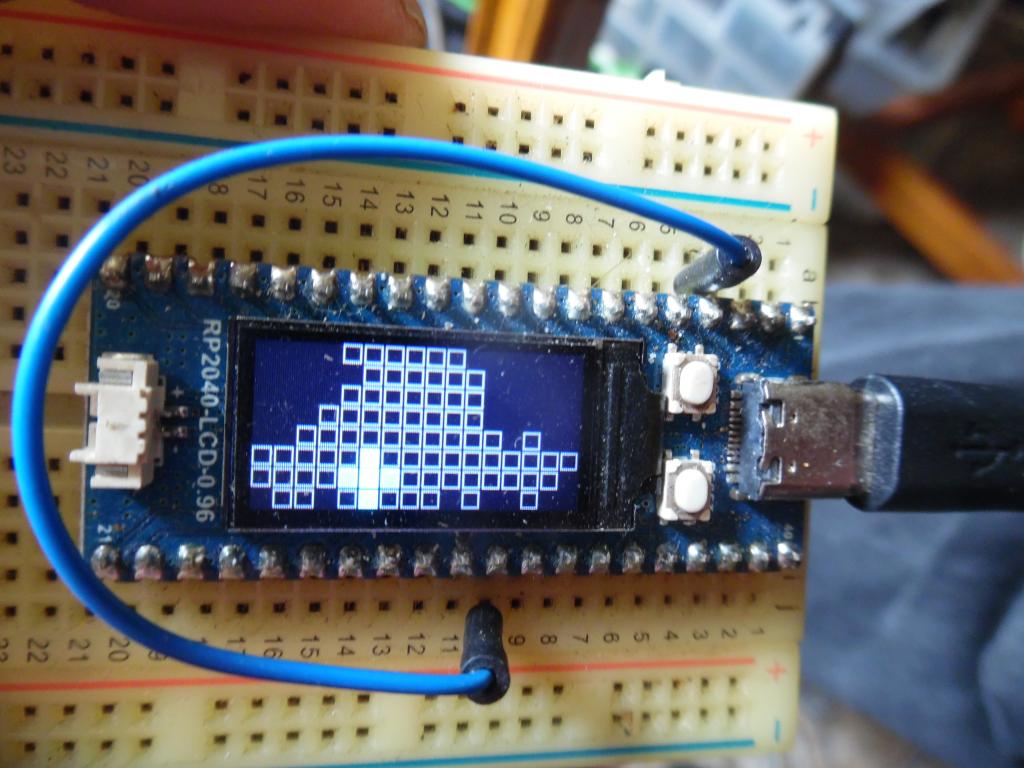

Posted: 03:25pm 30 May 2025
I bought one of these, waveshare?? it got mentioned ages ago.
