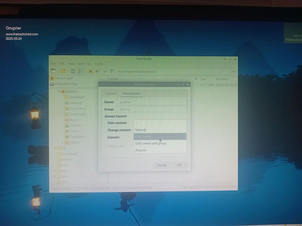

Used the PI5 to go to the Opera browser website, and download the deb for Linux.
Right-click on the file, set the EXECUTE permissions to "Only Owner", click OK.

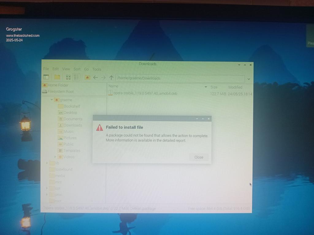

Now double-click the deb file, get asked if I want to install it, I say yes/OK, then get the following error message:
The PI5 is trying to tell me to look in the "Detailed report", which is fine, but as I am something still of a Linux novice, can someone point me to where I can FIND that report, and then maybe find out what the issue was.
Cheers!
Posts: 9081
Posted: 07:05am 24 May 2025
When you get this sort of thing there is a method that can help. Open up a terminal window (yes, it's command line time!), navigate to the location of the file you are trying to install and run the installer from the command line (you may need to use sudo to get permission to install it). You will usually get a whole load of stuff scrolling up, but it will stop where the error is - or not long after as it tidies up. Whether you understand the error message is something else, but at least it's a start. :)

Arm is not amd64!! Not sure of RP5 processor type but the package needs to fit to the architecture

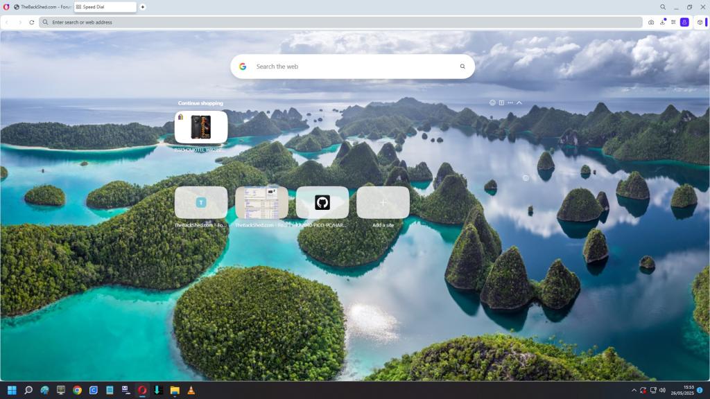

Posted: 12:59pm 24 May 2025
I use win Opera but it's not available for pi.
dddns
Joined: 20/09/2024
Posts: 910
Posted: 01:59pm 24 May 2025
  stanleyella said  I use win Opera but it's not available for pi.
There is a windows version  for the PI.
And there is a opera version  for windows on arm.

  dddns said  Arm is not amd64!! Not sure of RP5 processor type but the package needs to fit to the architecture
Good point.
That was a bit of a schoolboy mistake by me there....
I don't NEED to have Opera, I was just playing around with trying to install it, but I will drop that idea now.
