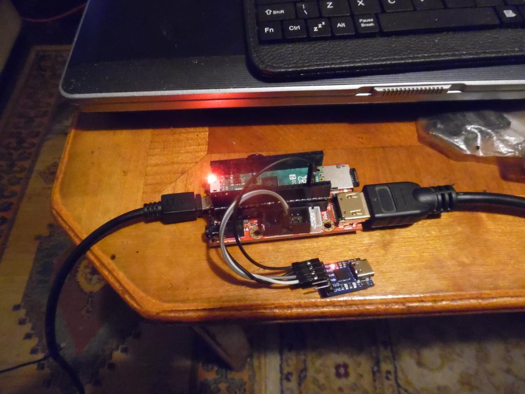

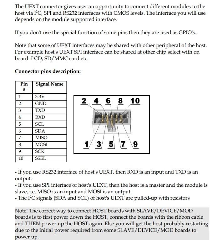

I notice using usb version usb to ttl works to program but needs dissconectig for code to run and connecting usb to ttl stops program running disconnecting it runs again.
just posted as beginners show interest in the board and be fair it looks tidy but it's got faults with mmb but mine is "working"

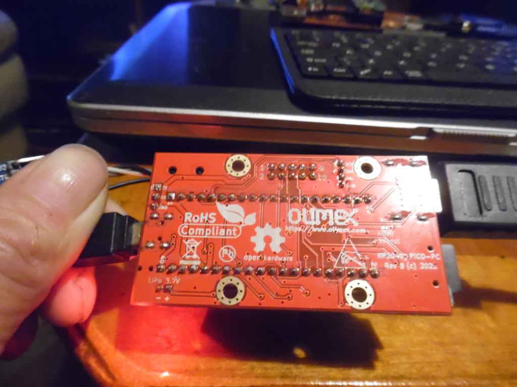

What is printed as product description on the backside?
I found a board looking like yours but seems to be originally designed for RP2040.
I think this is used by some here and can be setup with OPTION PLATFORM OLIMEX but I'm not sure. I looked at the scheme and I think its ok for the 2350.. Your usb problem sounds unusual to me, maybe other can help better.
scheme I looked at
I think your ground wire for usb is wrong..can'T see excatly but check
it's ground for usb to ttl
no usb connected, that is on the pico. power goes to the olimex board
all strange
edit checking usb to ttl sir
Edited 2025-05-22 06:46 by stanleyella
dddns
Joined: 20/09/2024
Posts: 910
Posted: 08:46pm 21 May 2025
I think you plugged it in one too far to the left. please check that
On the pico, not at the socket
Edited 2025-05-22 06:49 by dddns
Posted: 08:59pm 21 May 2025
I had the 5V from usb to ttl plugged in to ground doh.
plugged into vbus pin 40 and no need for power to olimex board.
mmedit working through usb to ttl ok.. which is usb c and tiny.
Thank you for your help @dddns

found from info 3.3V is input supply so use 3.3V out from usb to ttl instead of 5V to vbus... works

The board has its own USB connector for power source. Your USB TTL serial converter should be only connected to UEXT via GND,RX,TX

When connecting the Terminal via rx and tx next to the usb, note that they must be connected crosswise and then make a standard 3-pin cable so that it always works well.
