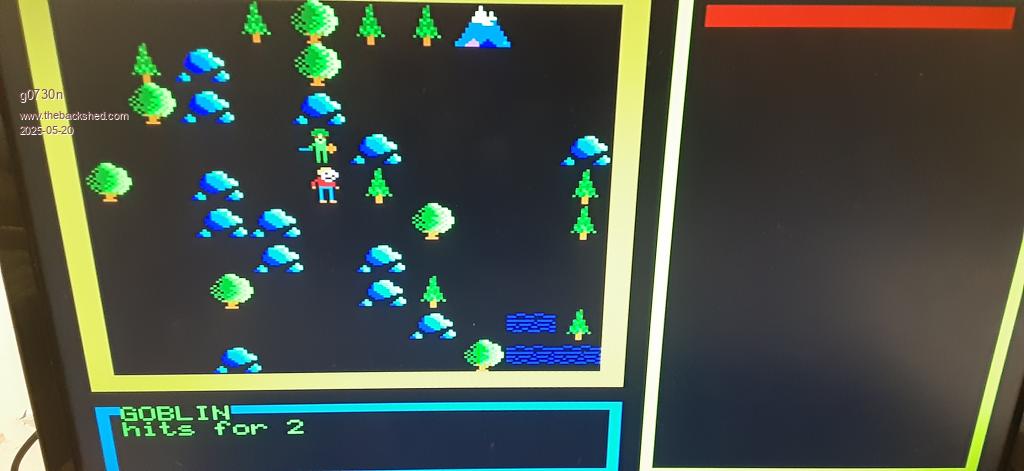

It's all working great!
I decided to make a roguelike/rpg style game, which is actually a remake of a text based game I made on the Smart Response XE running Arduino Basic, but was limited to 4k program size and wasn't able to fit the last bit in there so shelved it then lost the code.

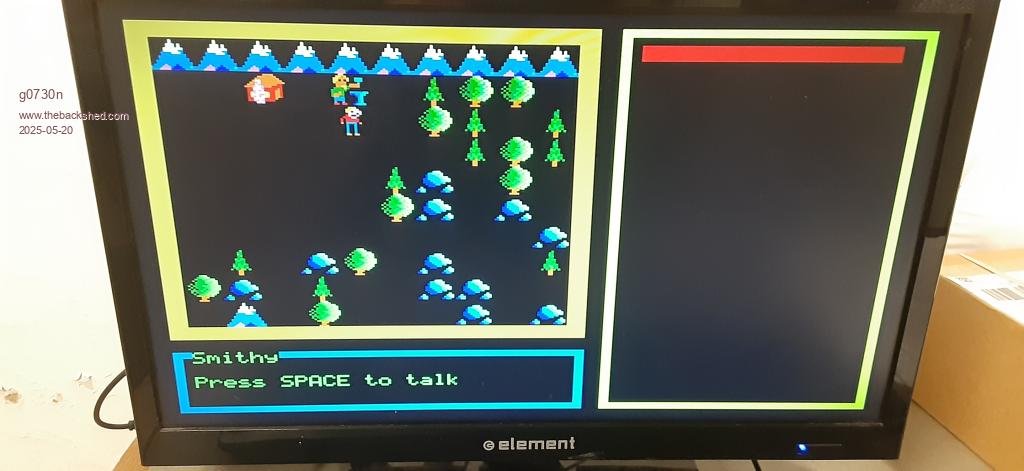

Awesome thanks guys lots of great info!
i usually use paint.net while on windows, martin the link you provided is very helpful for going that route.
so far I have created 36 16x16 sprites in this game I am making, using your mmbasic sprite editor. I may make a few more but i have pretty much done all tiles, enemies, npc's and items that will be used in game. i dont plan on animating anything at this point.
