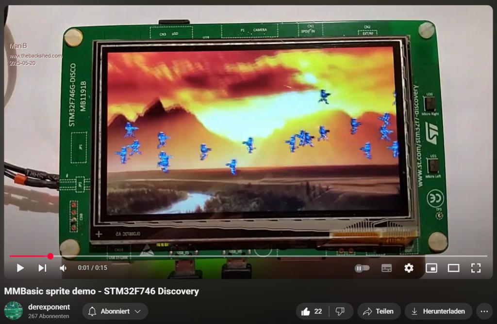

You need the power of the CMM2 to have some fun.
Here is a video of my brother who got MMBasic running on the STM32F746 Discovery Board:
https://www.youtube.com/watch?v=5g3-ztufoNM
More infos about on my blog:
https://mikrocontroller.bplaced.net/wordpress/?page_id=787
Or her in this forum:
https://www.thebackshed.com/forum/ViewTopic.php?TID=7969
Edited 2025-05-21 00:06 by ManiB

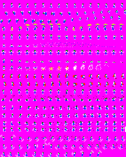

Fortunately, you can find the animations online
Amiga Spritesheet
or bigger
Lemmings 16x20
Edited 2026-08-11 15:53 by Martin H.

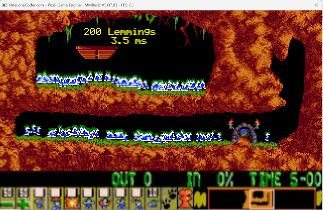

Posted: 11:49am 11 Aug 2026
  Volhout said  Hi Martin,
I think the 16x20 is not very suitable for a 320x240 resolution screen.
Hi Harm,
You’re probably right, but I’ve written a little demo/benchmark here anyway to see how many Lemmings can be moved.
lemtest.zip

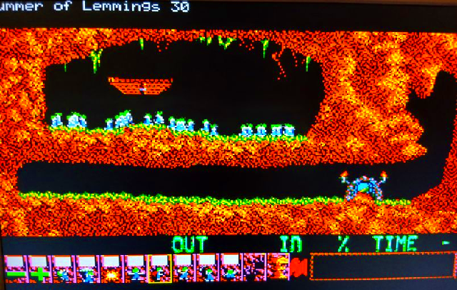

Posted: 12:16pm 11 Aug 2026
You have seen this ?
lem_core3.zip
100 lemmings walking...(the visible ones...)
Incidental you see a lemming flickering, but those are 2 lemmings exactly on top of each other.
Edited 2026-08-11 23:03 by Volhout

Posted: 08:06am 15 Aug 2026
I’ve put together the complete set for you here as sprites and CSUB file. These are 318 converted Amiga sprites which, to allow for freedom of movement, are still 16x16 pixels in size.
sprites.zip
You can, of course, create a Lib from it or read the BMP using BLIT FLASH. See which works best for you.
Have a good Weekend
Martin
