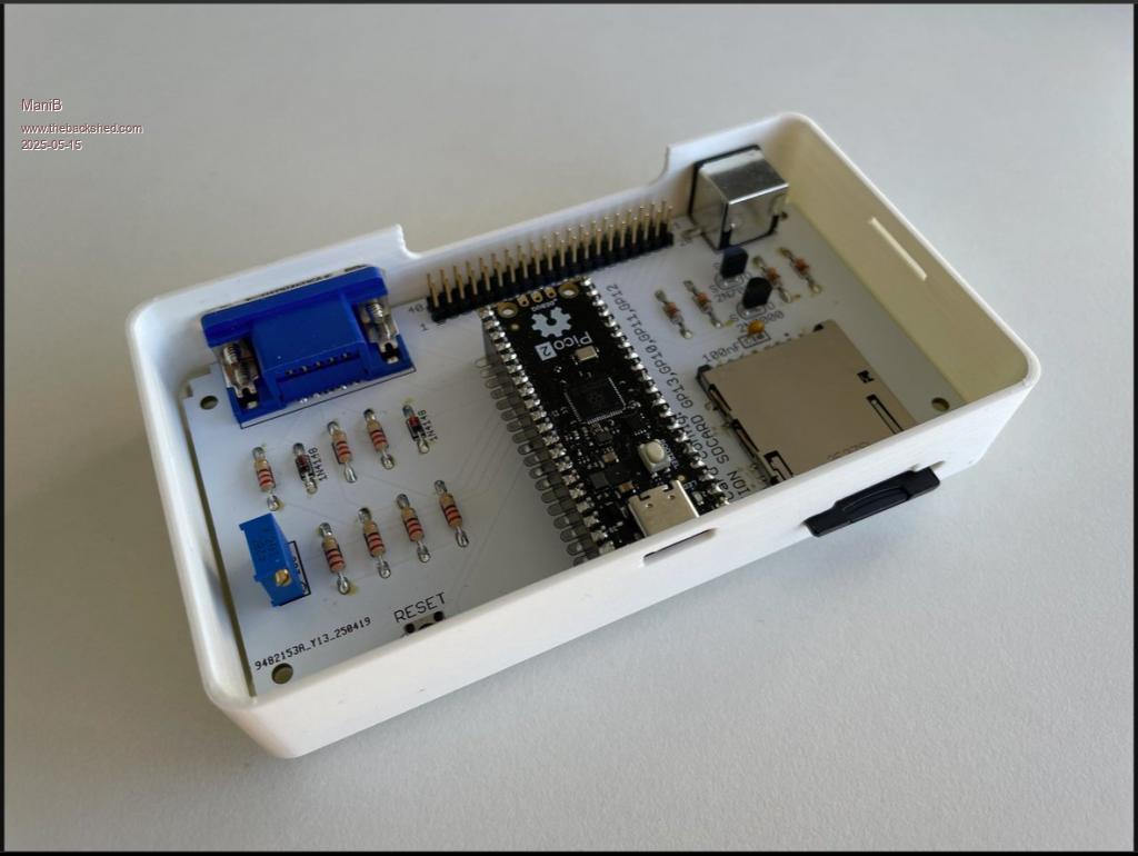

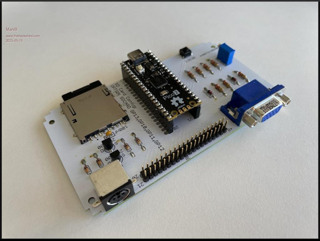

Is this option list coming from the device shown on the picture??

And yes, the OPTION LIST is from this device shown in the pictures.

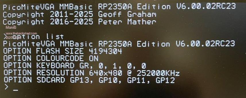

Yes, you are right, i made a mistake. The OPTION LIST shows:
PicoMiteVGA MMBasic USB RP2350A Edition V6.00.02RC23

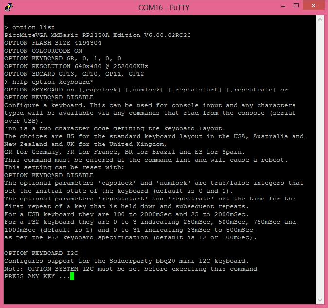

ManiB
Joined: 12/10/2019
Posts: 190
Posted: 09:31am 15 May 2025
  Mixtel90 said  This looks wrong.
Installing PicoMiteRP2350VGAV6.00.02RC23.uf2
will NOT give
PicoMiteVGA MMBasic USB RP2350B Edition V6.00.02RC23
OPTION FLASH SIZE 4194304
OPTION COLOURCODE ON
OPTION KEYBOARD GR,0,1,0,0
OPTION RESOLUTION 640x480 @ 252000kHz
OPTION SDCARD GP13, GP10, GP11, GP12
as OPTION LIST unless it's buggy.
The GPIO pin list looks correct though.
TassyJim is right. You probably need to clear the flash to reinstall the correct firmware.
Personally, unless someone can recommend a version that they have tested on this particular PCB design, I'd try one of the earlier Release Candidates or even 6.00.01, the last full release.
Yes, it is IS WRONG!
Sorry, I made a typing error when typing the screen message.
The corrected power-on message is: “PicoMiteVGA MMBasic RP2350A Edition V6.00.02RC23”
Here is the screenshot:
Im using a Windows 8 PC. I will try this out this evening with my Windows 10 Intel NUC computer and then report what happens there.
Thank you for your help.

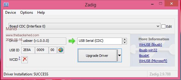

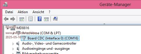

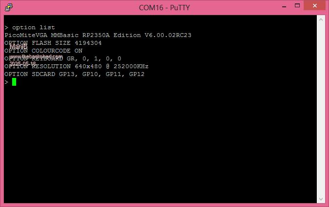

From the manual page 8.
Windows 7 and 8.1
The USB serial port uses the CDC protocol and the drivers for this are standard in Windows 10 and 11 and will load automatically.
The Raspberry Pi Foundation lists Windows 7 or 8.1 as “unsupported” however you can use a tool like Zadig
( https://zadig.akeo.ie ) to install a generic driver for a “usbser” device and that should allow these computers to
connect. This post describes the process: https://github.com/raspberrypi/pico-feedback/issues/118

  ManiB said
If an unknown device is plugged into Win then usually it requests a diver install.
Maybe it won't come up with this but then you should see an unknown device in the device manager. Please check
Try all of this on a plain pico without having it plugged in to your board
