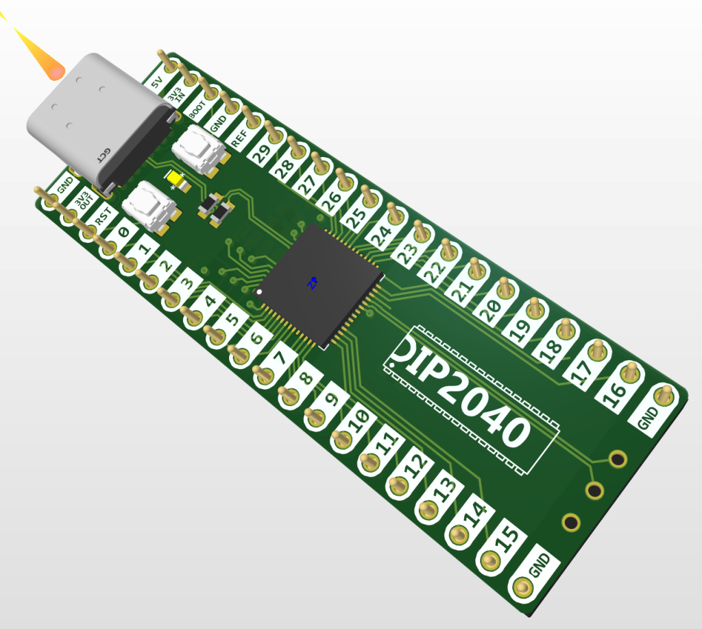

I'm not stuck to the pico boards either. I Make my own boards where i can access all the GPIOs as i please (apart from QSPI for flash or psram and an occasional SDCARD). Not interested in wifi either. Once debugging is done the program is set to autorun and even USB is not needed anymore. It's a canned microcontroller at that point.
i wish they would make a dip40 or dip68 (like the 68000) package... (with ALL the gpio's brought out and ditch the on-board noisy regulator. only USB-C , reset and boot button and flash/psram on the qspi). i may have to roll one.... the current boards are wider than a standard DIP40

A bit like this? (64-pin dual-in-line RP3250B development board)

  Mixtel90 said  A bit like this? (64-pin dual-in-line RP3250B development board)
kinda. but with different pinout and no shenanigans like adjustable core voltage
- Flash on board, psram optional with control on GP47. I want to retain GP0 so i can do parallel data writes without having to shift up 1 bit due to GP0 being occupied by PSRam_CE
- all gpio brought out
- usb switchable from connector to pins using solderbridges. maybe i will ditch even this. if i can find a longer usb connector.
- boot switch next to usb ( side activated). The idea is to put this at the edge of a carrier board and have the usb connector come out of the case. Tiny hole in the case to fit paperclip so you can poke the boot switch to throw the cpu into DFU
- optional vref generator (lm4040). you can feed VREF or pull from it if the LM4040 is installed.
- detachable Heartbeat led (solder bridge)
- esd protection on USB
- detachable 3v3 with solder bridge. for small applications that are usb powered you strap it and it becomes bus powered. if you unstrap it you need to provide your own 3v3
i want it as raw as possible.

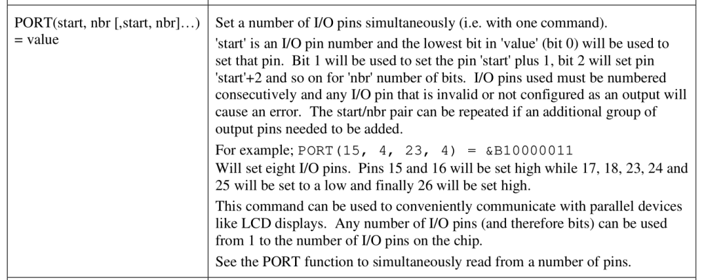

Parallel data read/writes: I kinda really like our PORT command/function. Maybe yours is a little faster?
Two issues :
1) That function operates on pin numbers. Not gpio numbers. if i want to set GP0 to GP7 i need to make a complicated definition to skip pin3 and 8(ground) . Pin numbers, in my opinion, are BAD : they tie you to a specific board. if somebody make a different board with different pin allocation nothing works anymore. IO should always be referred by using the processors pin name, not the boards pin name. But that's just my opinion. What do i know ?
2) looking at the C code of the interpreter the pin operations are sequential. They do not change at the same time but one after another. It's essentially a loop that scans through the list. This makes the actual output glitchy. if you go from 0000 to 1111 you get 0001 0011 0111 on the pins before you hit 1111. it gets worse when you go from a random pattern to another random pattern. Every bit flip produces an intermediary state.
The same for reading the port. The port is being scanned bit by bit. If you are trying to sample parallel inputs you can get wrong states if the inputs change during the scan. Let's say you want to make a simple logic analyser: if the data changes during the scan you get false information by using the PORT function.
It is not a true parallel read/ write.
My GPIO library is a true parallel read and write since it accesses the SIO registers directly. The inputs are sampled and stored into the input register in one clock cycle.

Posts: 11784
Posted: 10:03pm 09 May 2025
  Quote  That function operates on pin numbers. Not gpio numbers. if i want to set GP0 to GP7
Not true - try it.
  Quote  They do not change at the same time but one after another. It's essentially a loop that scans through the list.
Not true - they are all set simultaneously
Also not true. What source are you looking at. Clearly not the one on github.
Please don't post falsehoods that can confuse others
Not true - try it.
The manual could use some clarification ...
in external.c :
while(nbr) {
        if(!code)pin=codemap(pincode);
        else pin=pincode;
//         PIntComma(pin);
           if(IsInvalidPin(pin) || !(ExtCurrentConfig[pin] == EXT_DIG_OUT )) error("Invalid output pin");
           ExtSet(pin, value & 1);
           value >>= 1;
           nbr--;
           pincode++;
This looks like you are walking the given map and, when a pin is valid as output then calling 'extset' with the masked value for the pin . The pins are set one by one in a loop, not as a single transfer.
-edit-
Apologies. i blew away my copy of the source and pulled a fresh copy from github. Looks like i had an old version . 5.7
6.x has this routine changed. So it is parallel now.
