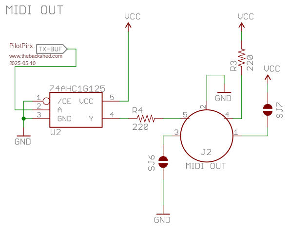

this should be no problem. It's an normal serial MIDI output with 31250Baud.
You only need a Midi Interface, an arduino midi shield for example.
Example MIDI Out (5V):
