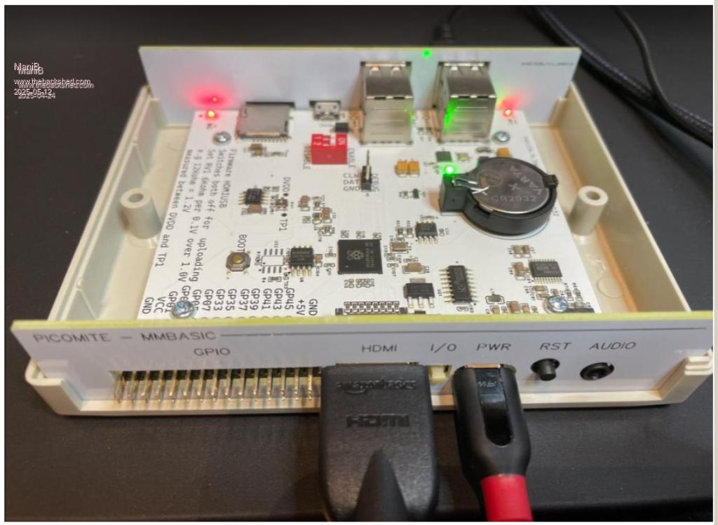

This is also an option with a Pico2 rather than a Pico1. OPTION RESET OLIMEX and it is fully configured

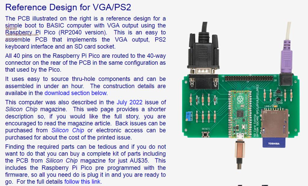

I try to make a piggy board with SDcard,mini Din(ps/2),resistors for VGA(use a 2x8pins connector) .. cause Vga to big for piggyback .
I use as reference PicoMiteVGA schematic.

I've done several weird and wonderful Pico boards. Some, but not all, can be seen by following the link in my sig:
PicoStick jams just about as much as you can onto a stick that plugs into the VGA scket of a monitor.

Peter designed this; it works well, but it's limited (No keyboard port, serial console only). A case is also available for it. It dates back to the time when RP2350 chips weren't available.

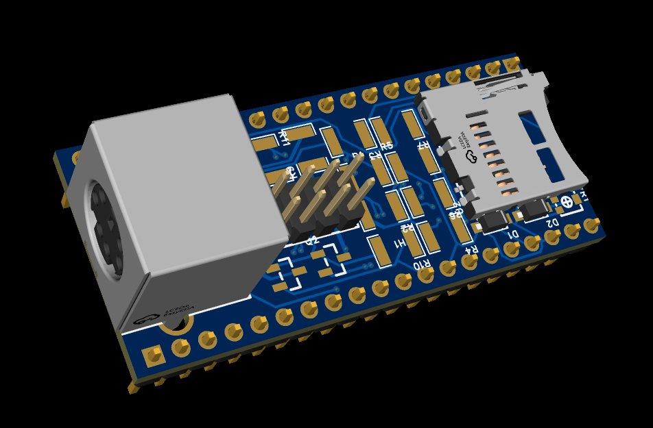

Posts: 9238
Posted: 07:01am 11 May 2025
To be honest it wouldn't be my first choice for a MMBasic platform. Especially as any VGA connector has to be remote and it's not breadboard friendly. You should be able to get it to work, but it's a bit of a kludge, isn't it?  :)

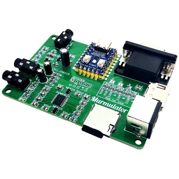

javavi
Joined: 01/10/2023
Location: Ukraine
Posts: 622
Posted: 07:27am 11 May 2025
My PicoMite works great on Murmulator's boards. VGA version on Murmulator 1 boards, and HDMI version on Murmulator 2 boards.
