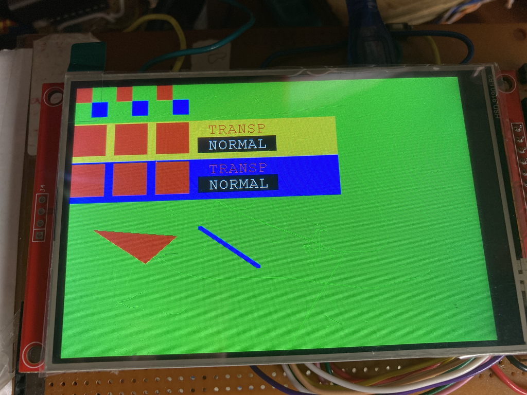

This is my test program result.
The first column is the source.
Next column is result of BLIT READ / BLIT WRITE
Next column is result of a BLIT.
Next is TEXT and Transparent Text
Triangle and LINE AA I think call ReadBufferSPI as well.
Various subtle things occur when it not right.
e.g. BLIT and BLIT READ/WRITE can give incorrect colours.
It seems to be correct with the two changes above.
Maybe its worth printing out the chip ID and see if its different from yours.
The test code is below.

F4 H7FotSF4xGT

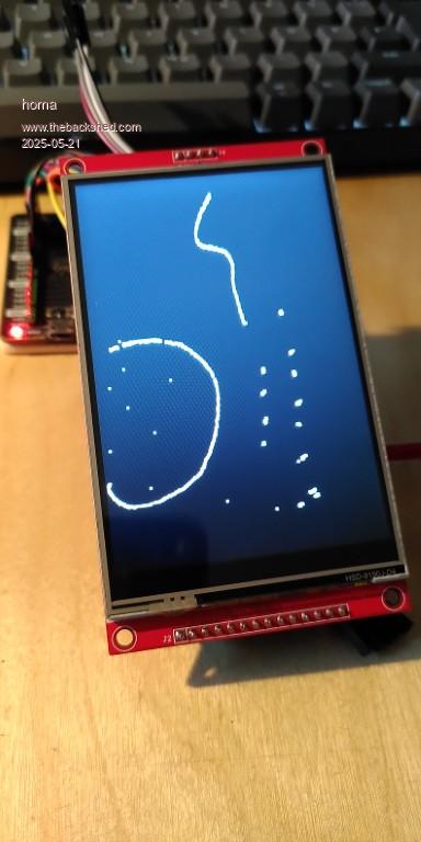

homa
Joined: 05/11/2021
Posts: 725
Posted: 05:31pm 18 May 2025
OK, my ST7796S display has arrived. Which pins are best to use with the Pico? Do you have any recommendations, Peter?
OPTION LCDPANEL ST7796S,orientation, DCpin, RESETpin, CSpin [,backlightpin] [,INVERT]
I don't have a pin header soldered into J4 yet, but I need to do so for SD card use, don't I?
Otherwise, could you just provide me with your option list? I'll try to make sense of it.
Thanks in advance.
Matthias

OPTION TOUCH GP12,GP11
GUI CALIBRATE 1, 154, 3980, 863, -1279
OPTION SDCARD GP17
OPTION RTC AUTO ENABLE
> gui test lcdpanel
> gui test touch
> RUN
ST7796S Test by disco4now 19-05-2025
F80000  RED F80000
F80000
1CC0    GREEN FC00
1CC0
F80000  BLUE F8
F80000
F80000
F80000  BLUE F8
F80000
F80000
F80000  BLUE F8
F80000
F80000
F80000
1CC0
1CC0
F80000
1CC0
WRITE TIME:      0.684
1CC0
F80000
BLIT TIME:       16.948
CLS TIME:       0.104
Using Peter's last .uf2
