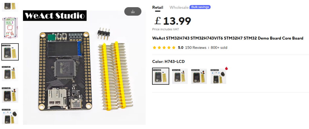

Posted: 09:02pm 29 Apr 2025
  Mixtel90 said
If you need a lot of space when using MMBasic then the CMM2 is the way to go, not the PicoMite. :)
That's not a microcontroller... i want something small, near single chip. don't need video output and usb host.
Think 8051+ft232 small.
Rpi2040 is cheap and small with lots of i/o
That H7 processor is a humongous tqfp.

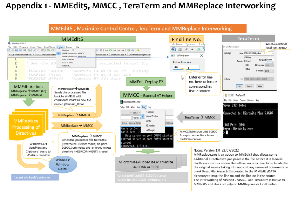

Posted: 10:07pm 29 Apr 2025
Maybe a compiled language such as C.
Or a preprocessor / transpiler - akin to Tom's (thwill).
Or a work-around as posted already.
For variables with MMBasic the RP2350 has more.

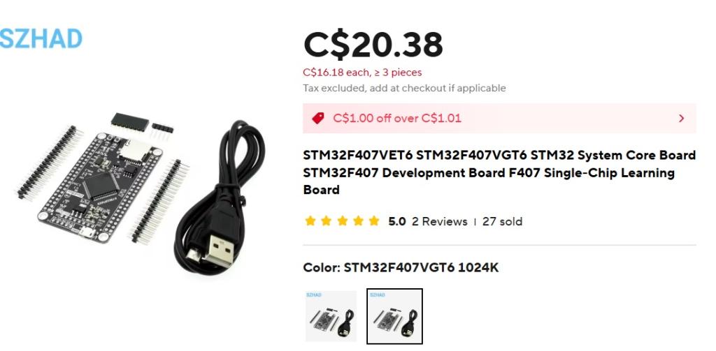

Posted: 11:39pm 29 Apr 2025
  vincenthimpe said  That H7 processor is a humongous tqfp.
Maybe you would want to look at the STM32F407VGT6 Development Board:
https://www.aliexpress.com/item/1005006882009420.html
If you go that way, make sure you order the VGT6 version.
can it run MMBasic ?
Even then. i'm rolling my own board. (there lots of other stuff i need)
Posted: 06:31am 30 Apr 2025
  vincenthimpe said
Yes
Lots of threads on STM32F4 CPUs and Armmite
Also on https://fruitoftheshed.com/wiki/doku.php?id=start
Various STM32 boards etc are supported.
