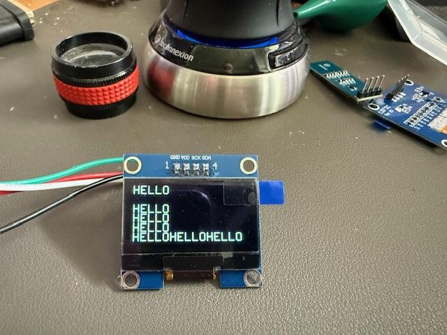

it works ! thanks a lot !

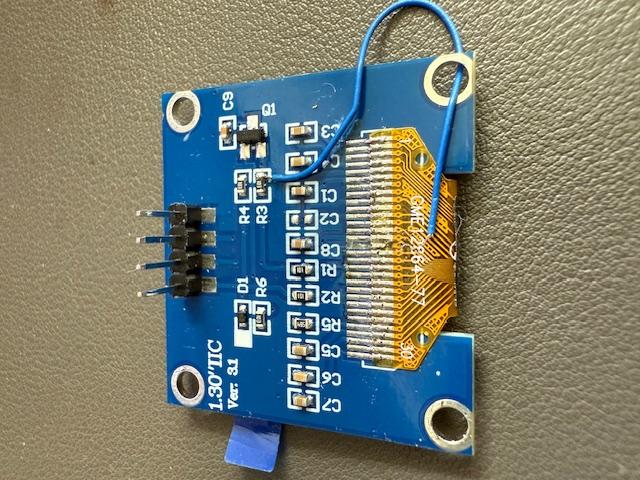

this would enable the use of two displays
Some board have the address bit switchable.
i had to bodge mine on the flex as the D2 trace was hard strapped under the flex.

OPTION LCDPANEL SSD1306I2C, LANDSCAPE, 2
Attached display with ssd1315 (1.3inch oled):
