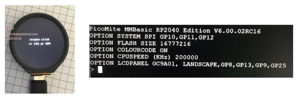

Hello,
Here is a short test/demo program for the CST816S capacitive touch display:
'Small test-routine for Waveshare RP2040-MCU Board 1.28inch touch LCD and gesture control
'Calibration & high bits for x and y coordinates are not needed
SetPin gp6,gp7,i2c2 'set pins of I2C2 interface
SetPin gp21,intl,SUB_TOUCH 'set interrupt pin
I2C2 open 400,100 'Open I2C2
CLS
I2C2 close
Sub SUB_TOUCH 'Interupt subroutine
I2C2 write &H15,0,1,&H01:I2C2 read &H15,0,1,g 'read gesture
I2C2 write &H15,0,1,&H04:I2C2 read &H15,0,1,x 'read x-coordinate lower byte
I2C2 write &H15,0,1,&H06:I2C2 read &H15,0,1,y 'read y-coordinate lower byte
If g=1 Then CLS RGB(green):Text 120,100,"slide up",C
If g=2 Then CLS RGB(blue):Text 120,100,"slide down",C
If g=3 Then CLS RGB(red):Text 120,100,"slide left",C
If g=4 Then CLS RGB(yellow):Text 120,100,"slide rigth",C
If g=5 Then CLS RGB(black):Text 120,100,"single click",C
If g=11 Then CLS RGB(magenta):Text 120,100,"double click",C 'no function ??
If g=12 Then CLS RGB(white):Text 120,100,"long press",C
Text 120,120,"x: "+Str$(x)+" y: "+Str$(y),C
Print g,x,y
PicoMite configuration:
More functions can be found in the register declaration:
https://files.waveshare.com/upload/c/c2/CST816S_register_declaration.pdf
Maybe it’s usefull for someone. Best would be if a driver could be integral part of MMBasic, then all other GUI-functions can directly be accessed.
