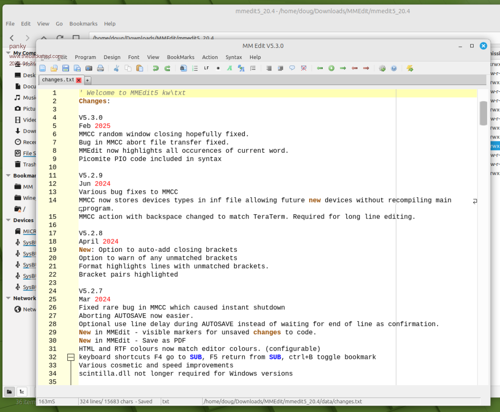

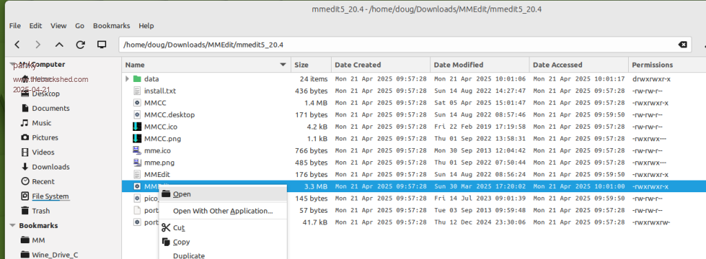

Check the permissions on MMEdit5 - it may not be executable first up.
I just tried, created a temp directory, downloaded and extracted the linux .tar from Jim's site, just double clicked on the MMEdit5 (the big 3.3MB one) file and up she came. Didn't need any extras for Mint 20.3.
The small MMEdit5 file (176 bytes) is for the desktop and just invokes MMEdit5 but as it comes out of the box, does not point to the right directory.
From the nemo file explorer, select the little desktop program, right click and select permissions - from there you need to put in the proper path to the large executable MMEdit5 program - you probably need to do the same for MMCC.

Since MMEdit isn't starting up for you, right click on the file "MMEdit", click on "Properties" in the popup box, then click on "Permissions". Check to see if the checkbox for "Execute:" is checked. This should already be done for you so I don't expect this to help.

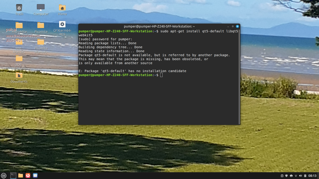

If MMEdit fails to run, you probable need to install some libraries.
From a command prompt run
sudo apt-get install qt5-default libqt5webkit5
I can't help you with any other incarnation of Linux.

Assuming you have extracted the files from the archive,
Have you run
if so, were there any errors?
If you don't have qt5 installed, MMEdit will not run.

Jim, This is what I get..
Posts: 6626
Posted: 10:42pm 20 Apr 2025
OK, I think that you are running a later kernel so try this:
sudo apt-get install qtbase5-dev
as per the readme.txt file in the main archive.
Linux isn't good for backward compatibility.

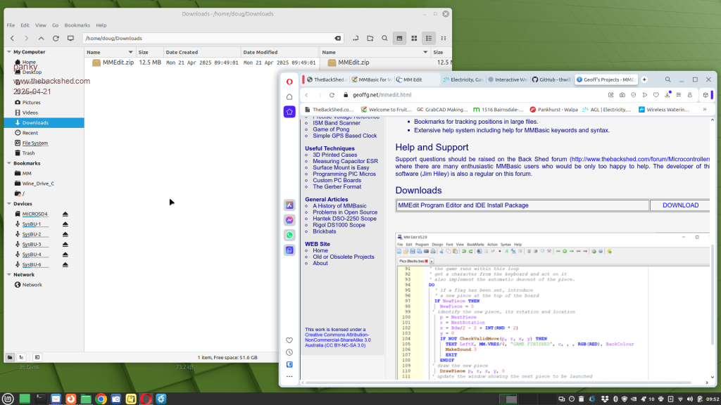

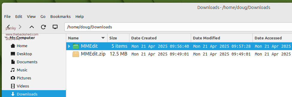

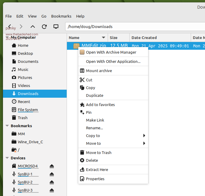

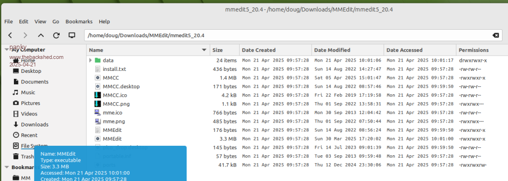

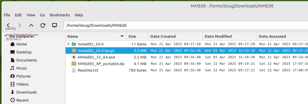

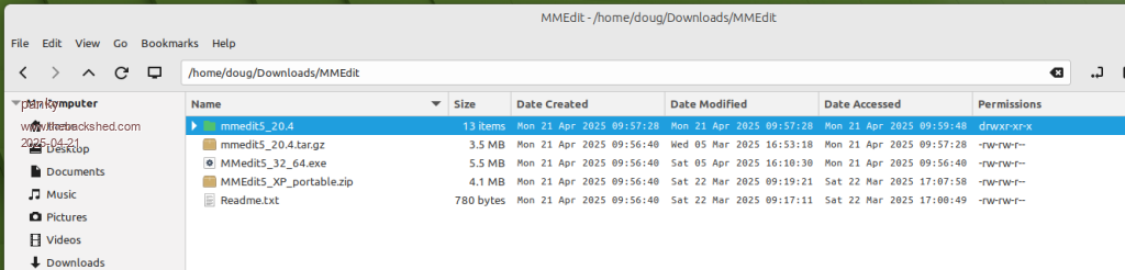

It's a little hard to analyse without sitting beside you but the following is what I did this morning to demo. I am running Linux Mint 20.3. Ensure you do not have MMEdit in your Download folder so this can be a clean install.
1. In a browser, go to Geoff's site  geoffg.net and select MMEdit IDE for MMBasic
This will download the file MMEdit.zip to your Download directory. You now need to extract the Linux version be selecting the file, right click and choose Extract here
You now need to select the .tar.gz file and extract MMEdit5
You should now have a folder  mmedit5_20.4  Inside this folder you will find all the MMEdit5 files.
You can now open (or double click to run) the mmedit executable file. Make sure you select the large 3.3MB version. The small 176byte mmedit file is for your desktop (don't worry about this yet - lets just get mmedit going)
This should result in you seeing MMEdit5 on your screen!
Hope this helps. Stick with Linux - once you get the hang of it (can be frustrating at times but no different from learning any new OS or program) you will find it more forgiving than Windows (just a personal opinion - please don't flame me).
Doug.

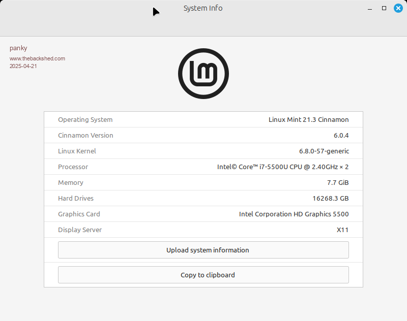

A slight update - I am running Linux Mint 21.3 not 20.3 - unsure as to what impact this may have. Can select System Info from your main menu as shown below to provide complete details of your version?

Posts: 1309
Posted: 02:04am 21 Apr 2025

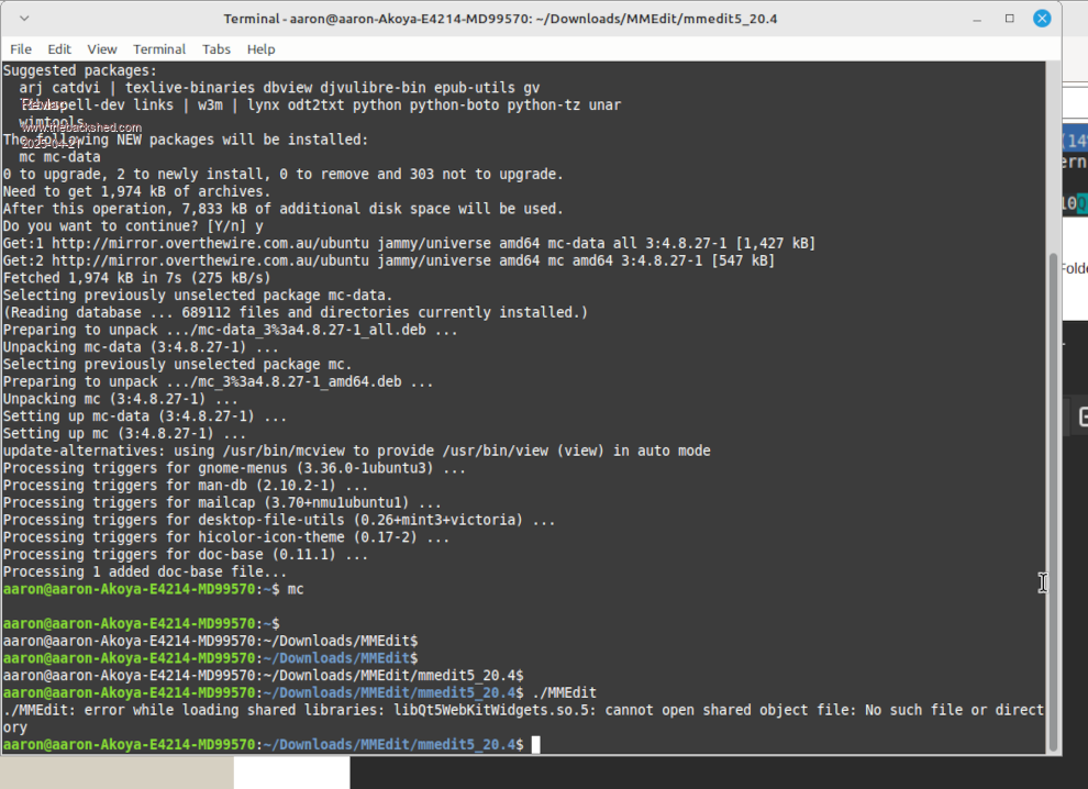

Also ave the same problem,
In the drop down list it has Execute, not RUN like the picture above.
Distro: Linux Mint 21.3 Virginia base: Ubuntu 22.04 jammy
Cheers Aaron

Right click on MMEdit and see the list...Sorry cant get a screenshot like the one above...
Cheers Aaron

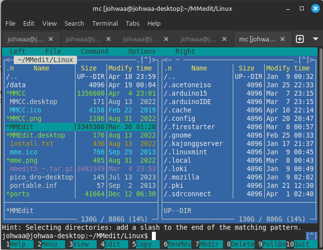

Let's take a step back and install Midnight Commander (https://midnight-commander.org/), which is a Norton Commander clone for Linux. It will allow you to easily navigate your system as well as being a huge help in maintenance and troubleshooting.
To install mc open a terminal and type this:
sudo apt-get install mc
Once completed, type mc in your terminal and hit enter.
If you haven't already unpacked MMEdit, please do so. I put mine here:

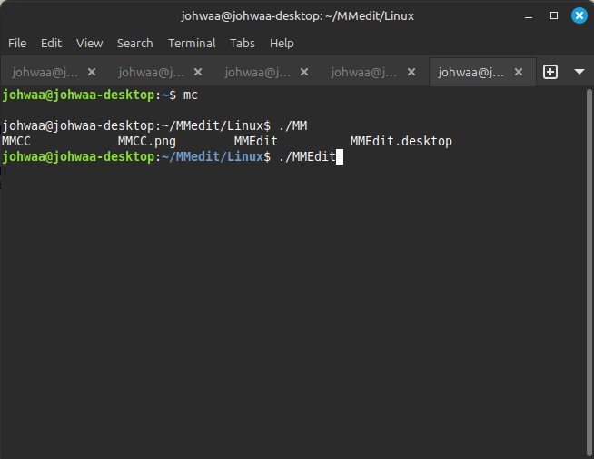

Then hit Control-O to toggle to the terminal display (hitting Control-O a second time will bring you back to the Folder/Default view). It (will shortly) look like this:
Type in ./MMEdit (or as I did ./MME and then I hit the TAB key). Please note that you need the preceding ./ for bash to find MMEdit since this folder is not included in my PATH.

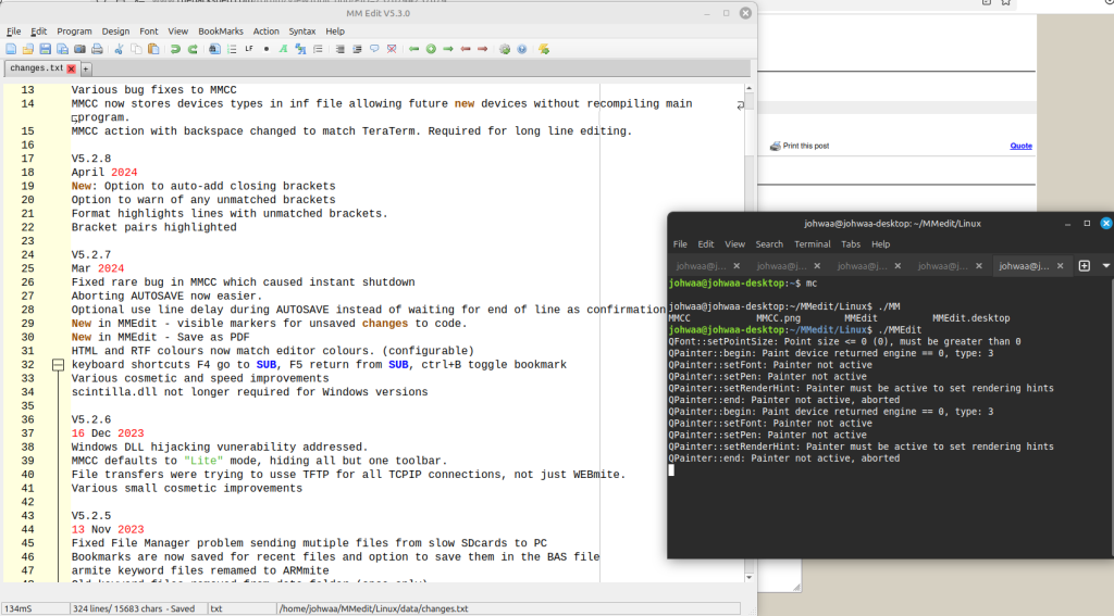

So please do that and hit enter. This is what you are not likely going to get:
Your terminal will now act as a connector to MMEdit, and any error messages should be displayed in the terminal before MMEdit crashes and closes. Please show us what it is complaining about.

Revlac
Joined: 31/12/2016
Posts: 1309
Posted: 03:20am 21 Apr 2025
Thanks  SimpleSafeName
That MC is nice,
Didn't see this before,
libQt5WebKitWidgets.so.5
Will check back later have other work to do now
Edited 2025-04-21 13:21 by Revlac
