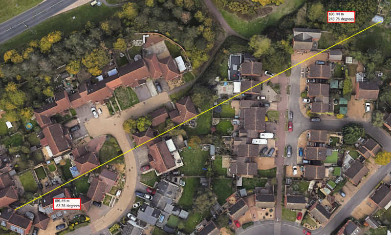

Posted: 02:00pm 15 Apr 2025
This is deinitely suburban. Residential to the south, warehousing/light industrial west, open countryside (for now) north and east with a highway in a cutting... so my plan is:
1. test with cheap crappy 433MHz modlues... don't judge, I have some on hand and with a full-wave whip might just be OK. The Tx are surprisingly good simple OOK devices - a bit messy but... it is usually the Rx that let's the side down. This is mainly me being cheeky and seeing if I can get it to work. Really tempted to skip this stage but it's an easy test and I'd like know if possible - I have read about people getting these to 300m LoS with a balanced dipole both ends, so who knows, sub 200m, almost LoS... if you squint at it and accept lofts are mainly empty space with some wooden bits... I actually think the line-up on the signal path is remarkable apart from that first building.
2. same test but with HC-12s... my first "serious" attempt to do it without LoRa. Again I have HC-12s on hand and I think the chips involved will make the absolute best of what can be had (from experience). If the Lora thing wasn't available I would focus on the antenna here but I think that has probably become un-necessary (saving me 60 quid)
3. I have a couple of HC-15 LoRa modules coming. If they do what they say, I think they will be the end of my tests if 2 fails. Actually, if they arrive before I am ready to do the tests, I will probably skip 1 & 2. I expect good things but I am worried about the lack of chat out there about these HC-15s specifically and the prospect of picking up a couple of duds.
4... 5... will very much depend on the outcomes of 1-3 but I think it will go down the LoRa route regardless. I will have to see. If I get to this stage and it still isn't working, I have plenty of info to proceed with.
@Volhout cheers for that link harm. the Tx antenna will be on a small mast but I am by-lawed to about 2.4m. Rx antenna will be at eaves level on a normal two-story building (about 3m+)
see? I told you I knew nothing about antenna design/capability... just that these little pigtail things are ok for short distances. TBH, I am not expecting to go down the yagi route now... if the LoRa modules check-out that is going to be it. Only if they turn out fakes will I start to consider HC-12s on a directional antenna - I also have aesthetics to consider
cheers all
h
Edited 2025-04-16 01:17 by CaptainBoing

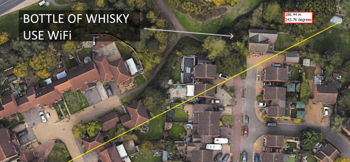

My solution is about 70 pounds (give or take), but probably fairly foolproof.
Bring a bottle of whisky to this house here. Tell the owner what you want to do and offer the bottle of whisky in exchange for tapping into his WiFi.
If he refuses - you still end up with a bottle of whisky - so there's no way you can lose out.
Posted: 07:37pm 15 Apr 2025
nice try.  fraught with future problems, and you missed the bit about 'don't want this to become "an internet thing"' Probably just easier/cheaper to use a flipper and steal his wifi creds: Future problems mitigated, zero cost... slightly dubious method
but I like your thinking
