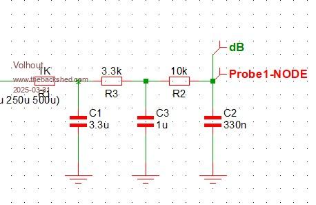

I went through this for my PWM controlled linear power supply.
To get 16 bit resolution in a pico (peripheral clock = 63 or 66MHz) the PWM frequency must be 1kHz or lower.
To achieve less that 1mV ripple, the filter attenuation must be 70dB or more.
Following filter can be used, giving 72dB attenuation at 1kHz.

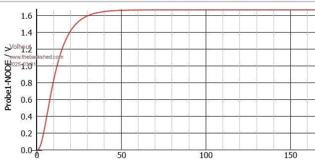

This filter has 16ms delay and settles within 1% in 40ms. Maybe this si fast enough.
I am not sure if this is acceptable for your application. If you need less resolution, your PWM frequency can be higher, and delays get less. If you can accept more ripple, you can make a simpler filter, and delays can be less. Some can be optimized using active filters.

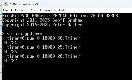

  matherp said  The update is at the end of the PWM loop so at 20KHz it can update once every 1/20000 seconds + any MMBasic processing time
Wait, what? This has been an issue for me:
pwm 1,18000,mcmd
I'm hoping that I've done something dumb here because I have tested many times and this line adds >1mS to my code execution.
I have, therefore, dropped PWM and gone with a SPI DAC.
Posts: 12059
Posted: 01:11pm 31 Mar 2025
First time sets up the frequency so takes a bit longer

Sure enough, from the command line, I get 0.130
WTF! When I ran it in my code, I confirmed with both TIMER and my scope that REM-ing-out that line, cut my execution by a touch > 1mS.
Need to revisit this.
