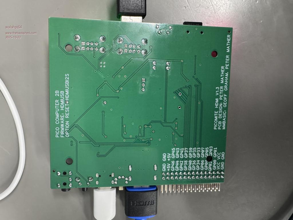

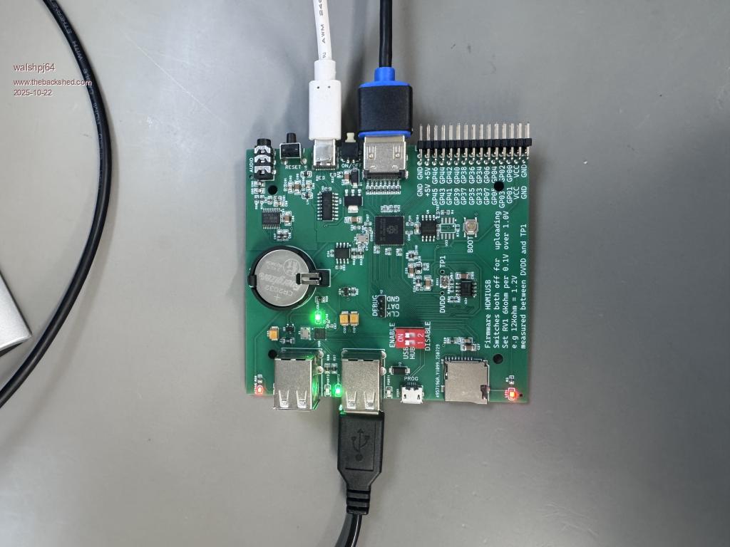

Please post a picture of the board so I can help further.

Hopefully the pics are OK.
