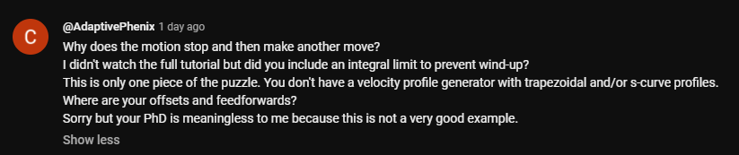

Something not right with this guy. Here's my comment:

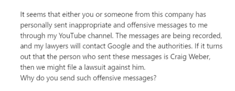

And so he went to my old LinkedIn and posted:
Where did I use "hurty" words?
I asked questions and he didn't answer a single one of them.
He is showing the worst performing example of a motor PID that I am able to find on YT and yet he insinuates that everyone else has got it wrong.
"Qualified to teach"
Really?
Any real/responsible designer would put safety first & foremost but this guy doesn't even mention it, let alone implement it. Motion is dangerous.
Take his awful example and apply it to say, a linear slide axis.
Should the feedback system fail due to:
1) a broken cable
2) PSU failure
3) feedback polarity out of phase with the motor (it happens)
The axis will run away at full velocity and the axis will crash spectacularly.
He has the equivalent of:
position_error = commanded_position - actual_position
motor_command = Kp * position_error
What must absolutely be (bare minimum):
if abs(position_error) > safety_limit then
 disable_servo
 emergency_stop
else
end if
