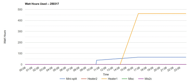

The program processes the input and fills an array with the cumulative kilowatt values for each device for each of the 240 time slots.
The program shells out to copy a standard header file to the output, then generates the data records for each time slot, and then shells out again to append a trailer file. Finally the output is copied to /var/www/html, from which web pages are served. Then any device on my network can retrieve it.
For this instance, I only have 2 devices running for part of the day. (My real application is for when I return to Canada in a little over a month.).
Here's the standard header file:
!DOCTYPE html>
<html>
<script src="https://www.gstatic.com/charts/loader.js"></script>
<body>
<div id="myChart" style="width:100%; max-width:1600px; height:500px;"></div>
<script>
google.charts.load('current',{packages:['corechart']});
google.charts.setOnLoadCallback(drawChart);
function drawChart() {
// Set Data
const data = google.visualization.arrayToDataTable([
['Time','Mini-split','Heater2','Heater1','Misc','Mis2c'],
And the trailer file:
 hAxis: {title: 'Time'},
 vAxis: {title: 'Watt Hours'},
 legend:  { position: 'bottom' }
// Draw
const chart = new google.visualization.LineChart(document.getElementById('myChart'));
chart.draw(data, options);
</script>
</body>
</html>
I apologize that I don't have a better example.

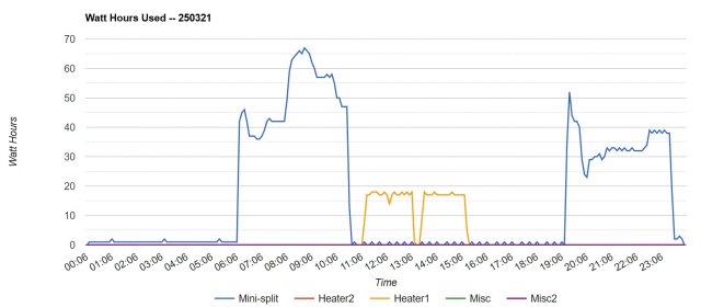

Here's the chart for kW per 6-minute period per device--in this case a 12000BTU heat pump (not having to provide much heat on a March Florida morning, and not much again in the evening) and a 200W electric heater:
To run this I took advantage of the options Tom provided for MMB4L to be invoked with parameters, so this runs the program:
mmbasic chartkwh.bas 250321 slot
The arguments tell it the date (250321) and to use the number of kilowatt hours used in each 6-minute "slot". (If slot is omitted, the chart will show always-rising lines of accumulated usage over time.)
Here's the program:

The tiny pointed blips ("^") on the blue line show the mini-split using only about 1 watt hour every 2 hours with the temperature turned down overnight, and then during the day when no heat was called for, but with the temperature set higher, about once every 18-24 minutes. This is of course a level usage, and the blips only show when the JSON variable "Today" (cumulative kilowatt hours) increases by 1 since the previous 6-minute time slot.
