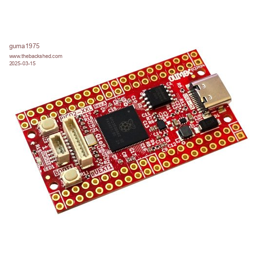

I bought a few olimex modules.
Unfortunately the maximum CPU clock is 240MHz
option cpuspeed 240000 above it hangs or degrades to a lower clock.

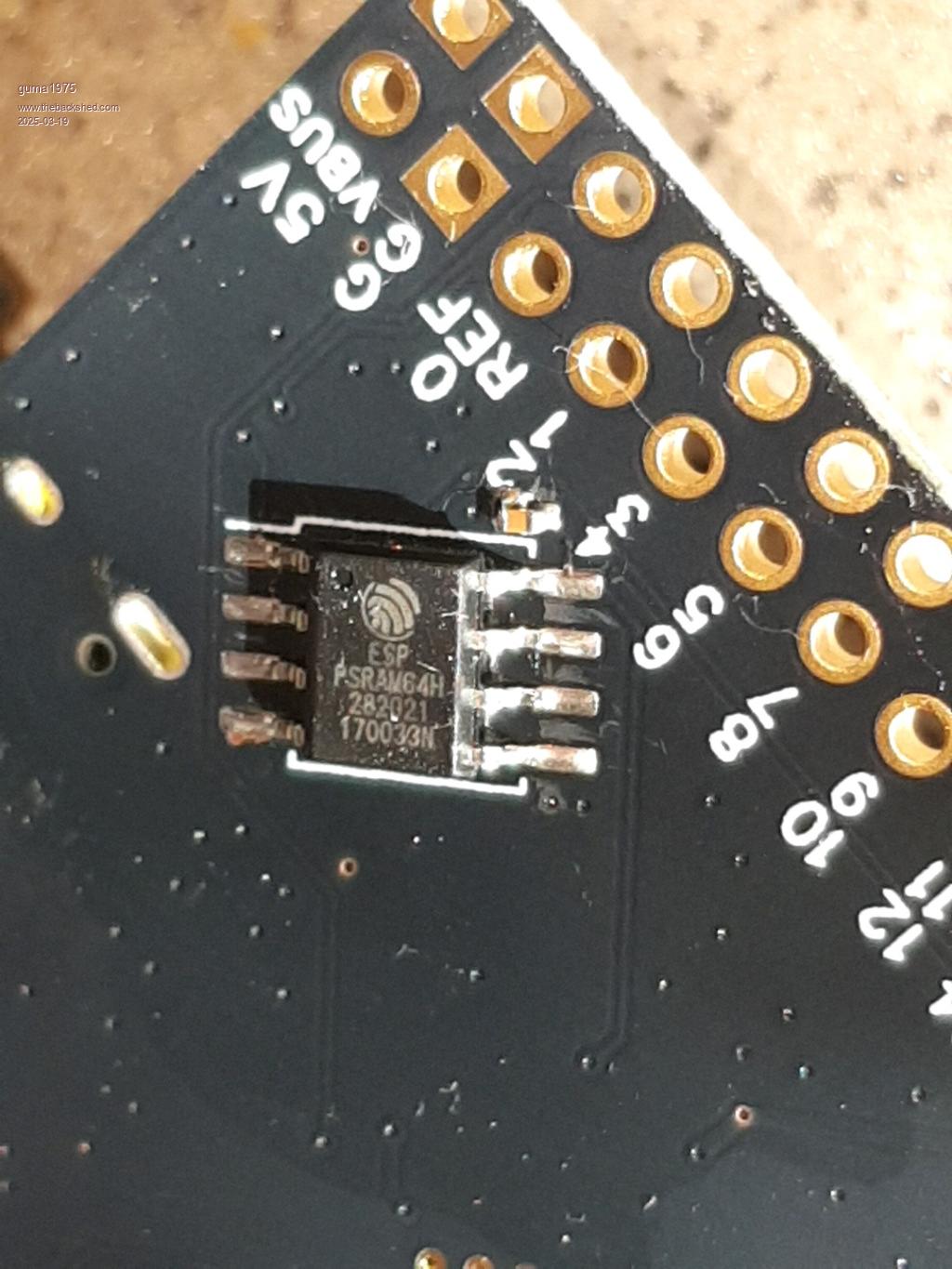

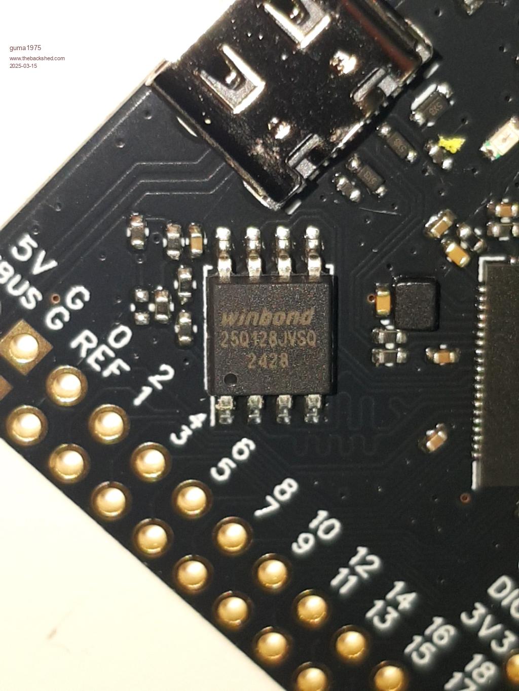

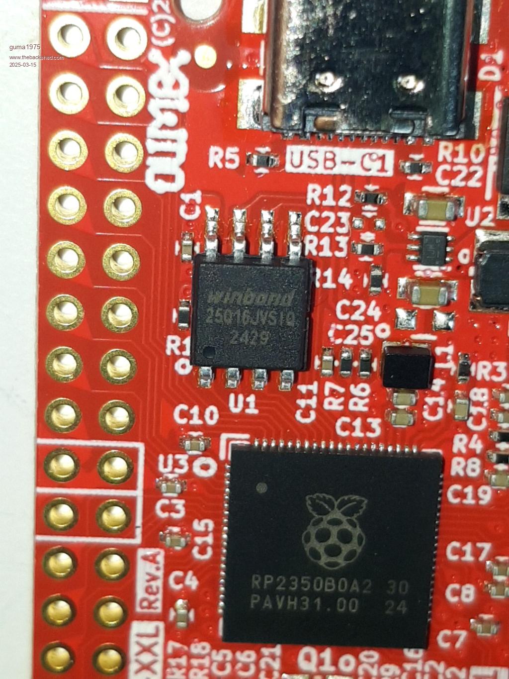

The memories differ only in capacity and are from the same family and company. I only wonder if it is not a problem of the length of the paths leading to this memory. In Olimex, pin 2 and 3 of this memory is shorter than 5 and 7. In Weact, there are visible zigzags of PCB paths on pins 2 and 3. Could this be the reason that Olimex does not work above 240MHz?
Olimex memory...
Weact memory...

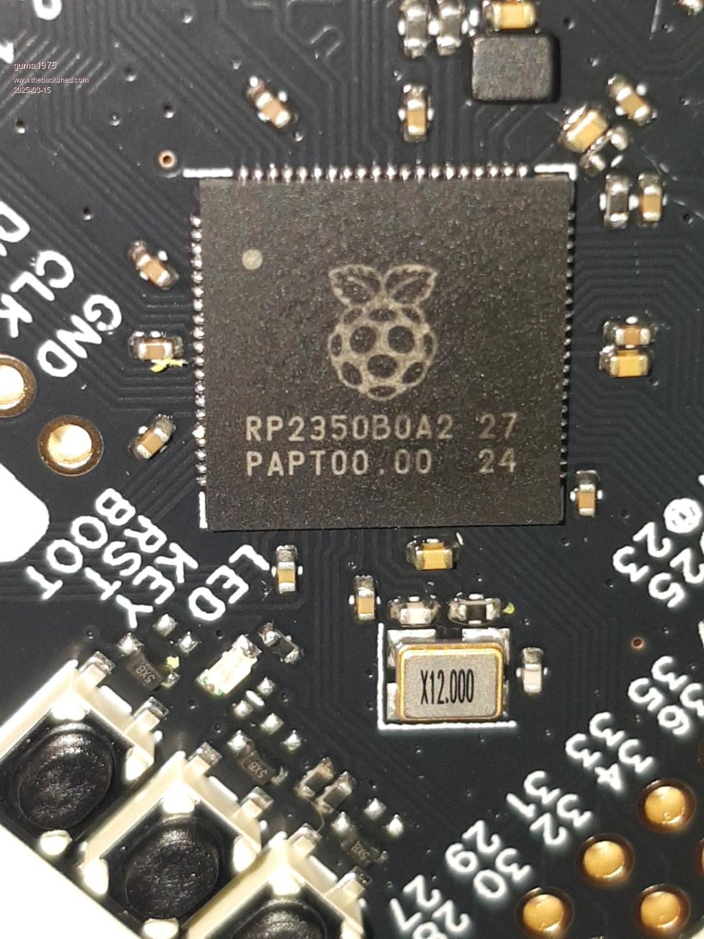

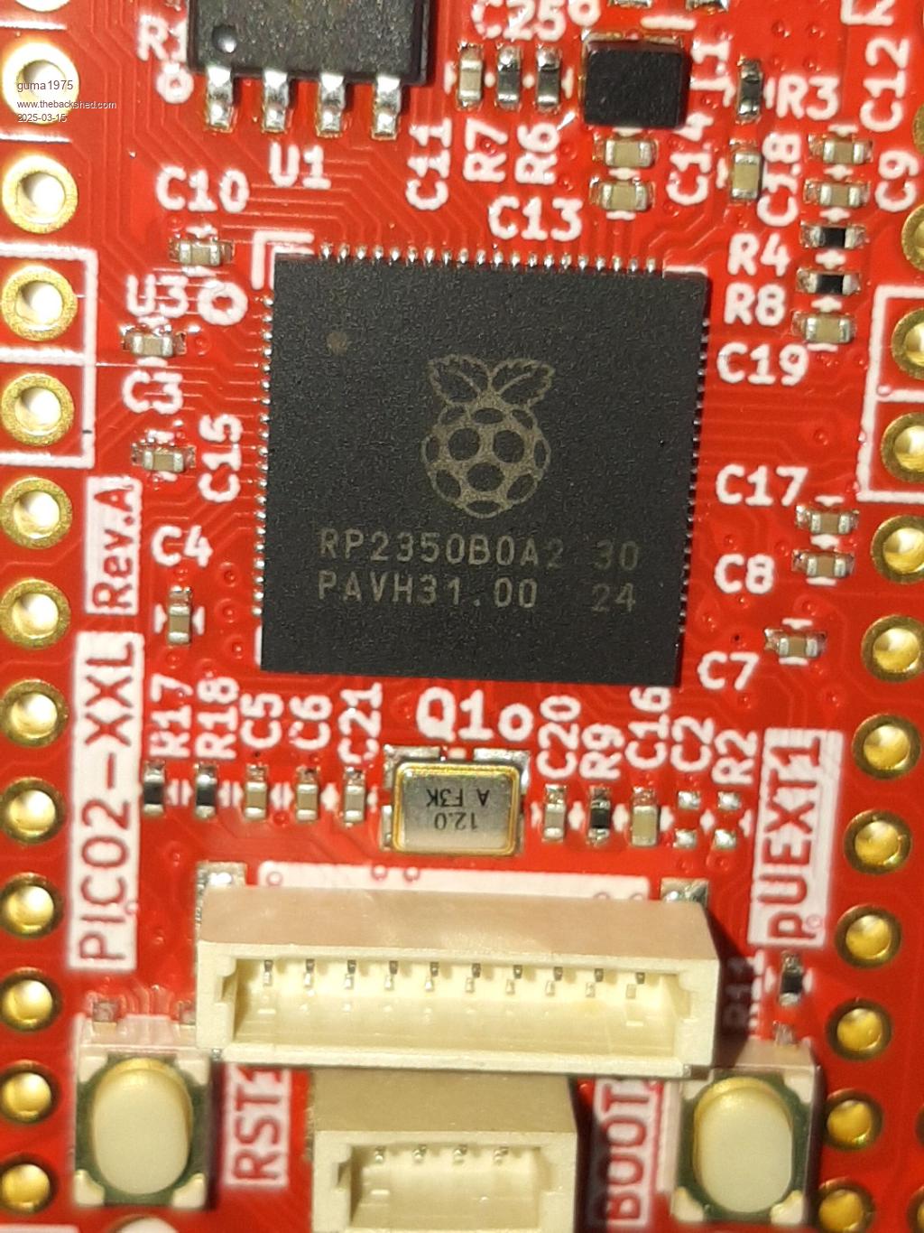

And photos of the rp2350b itself, the markings are the same. The only other ones are below the markings, maybe it's just the series?
Or maybe the core voltage is too low and maybe it can be increased a bit? Is it feasible? I wonder what you all think about this. Best regards.

I soldered to weact psram from aliexpress works at 378MHz. Additionally there was a place for a capacitor I soldered 100nF.

I replaced the 25Q16 memory in Olimex with a 25Q128 from AliExpress and the speed at which the board works increased to 330 MHz, above that it doesn't work. That's a small success.
PhenixRising
Joined: 07/11/2023
Posts: 2100
Posted: 01:23pm 17 Apr 2025
  guma1975 said  I replaced the 25Q16 memory in Olimex with a 25Q128 from AliExpress and the speed at which the board works increased to 330 MHz, above that it doesn't work. That's a small success.
Did you test after removing the 25Q16 before adding the 25Q128?
guma1975
Joined: 13/01/2023
Location: Poland
Posts: 16
Posted: 06:51am 18 Apr 2025
No. I think pico won't start without this memory. From 25q16 there was only about 36kb for the program by issuing the files command.
From 25q16 max speed 240MHz from 25q128 max speed 330MHz.

Hello again, encouraged by the fact that in the olimex pico2 rp2350 XL, replacing the flash with 25q128 improved the state of affairs regarding the operating speed and the size of the disk A: I decided to add the same psram that I soldered to weact. Despite adding a pull-up resistor R16=10k and C26=100nF according to the diagram and soldering the psram, everything hangs after issuing the option psram pin gp8 command. Unfortunately, this pcb probably won't work with psram. I changed the psram to the second one again, maybe the first one was damaged. Unfortunately, it didn't work either. I checked if gp8 pin6 rp2350 is connected to pin1 psram - it's ok. The power supply is 3.28V but on pin 1 psram is sometimes 2.65V, I could check with an oscilloscope, but I didn't. If I sleep on it, maybe I'll figure something out.
One thing worries me. All pins for flash memory and psram are brought out to the main bus, i.e. gold pins or whatever it's called. Maybe the lines are getting too long and the parasitic capacitances are doing their thing. But if that were the case, soldering psram probably shouldn't make things worse since you can overclock the clock to 330MHz on 25q128 alone. Of course, I tested psram at 150MHz and it doesn't work.
