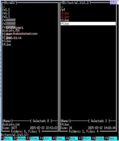

This is a branch of the main File Manager thread.. This isn't about a finished program, but rather about developing a simple file manager that only requires a terminal program (like Teraterm) and a Picomite. Criticism and suggestions are welcome. However, only requests of general relevance can be fulfilled. For example, the display size and the screen saver timeout can easily be adjusted in the source code to suit your needs.
The important thing to remember is the settings in the Terminal program: the screen display must be white on a black background, and the font should be "Terminal."
Have fun!
This is the VT100 console version of Vadim's (Javavi) FM (still beta!). It's functionally equivalent to my last test version for HDMI/VGA. I've optimized the display of selected files for VT100.
fm-vt100-noVGA1-02020.zip
What's missing?
It needs to be cleaned up. There's a lot of junk, and optimizations are possible. The code should run reasonably reliably and stably, as no complaints have been posted so far. I'll probably integrate the disk info module and the calendar into my private version. The ASCII module helped me a lot with conversion and could continue to do so. I've converted the color table to a test page for VT100 color codes. This is useful during development.
- The WDISKSELECT() function should be revised (Requires a Pico with an SD card!).
- There are minor cosmetic or display errors in some places.
- I'd also like to have a way for the file cursor to jump to a specific initial letter.
- There also seems to be a bug in the Deletedir() routine. It works adequately, but not as expected. I'll investigate ...
- We should also look at Vadim's new ideas and adopt them if necessary.
But I'm actually very satisfied.

This is the next improved version of FM V0.2023.
In addition to fixing a few minor bugs, there's a new feature: displaying the total file sizes of the selected files.
fm-vt100-02025.zip

This new version of FM for VT100 includes several visual improvements and standardizations.
fm-vt-02026.zip
Also included are the DiskInfo program for VT100 and the Calendar program for VT100.
The Diskinfo program (di.bas) displays the directory tree of a drive or directory. It can be called from the file manager using F12 and returns control to the FM upon completion (with "flash run 2," provided the FM is in flash slot 2). DI can save the directory tree to the drive for later viewing/analysis with the FM (or "List"). It is also possible to display only the summary.
Both programs (DI & CLDR) should be configured to the existing hardware (SD card or no SD card, RTC or no RTC, etc.) before use. The calendar actually assumes that an RTC is installed; if no RTC is present, the current date (and your own appointments) must be entered manually.
I'm usually assuming a minimal configuration with a bare Pico2 and a terminal program (Teraterm in my case).

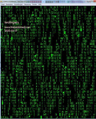

Posts: 6050
Posted: 03:10pm 16 Mar 2025
Hi Michael,
Here is a new screensaver. It is based on 256 color implementation in the terminal program. Looks a lot closer to the original...
It is tested on Putty.
I will see if TeraTerm works on monday.
'SCREEN SAVER - Matrix
Sub SSMatrix
Local matr(CHR),clr,x,fade(CHR),e$=chr$(27)+"[38;5;"
dim ink$(7) length 10 =(e$+"16m",e$+"16m",e$+"16m",e$+"22m",e$+"28m",e$+"34m",e$+"40m",e$+"46m")
For x=1 To CHR:matr(x)=CVR*Rnd:fade(x)=int(rnd*15):Next
 For x=1 To CHR
   Print ink$(int(fade(x)/2));
   Print @(x*FW-FW,matr(x)*FH)Chr$(Rnd*223+32);
   If matr(x)>CVR  Then matr(x)=0 Else Inc matr(x)
   inc fade(x),-1:if fade(x)<0 then fade(x)=15
 Next
 Pause 20
Loop While Inkey$=""
Print Nc$;
P.s. the strings are 9 characters long, so bothe 2040 as well as 2350 could define them as constants…

twofingers
Joined: 02/06/2014
Posts: 1769
Posted: 03:33pm 16 Mar 2025
Hi Harm,
why wait until Monday? I think it looks good! (But the screensaver isn't that important to ME.) It's a good exercise!
I was  wondering about whether certain patterns could shine (as black) through. Something like a skull or something similar.

Posts: 6050
Posted: 05:51pm 16 Mar 2025
Michael,
2026: Selecting multiple files works nice. Also the display of files and file size is fine. I have not tried yet with very large files, to see if size digits are cut off(*). But showing size is handy, then you know it actually fits (i.e. on the A:/ drive).
The only thing I found remarkable is the color of the popups. "Are you sure" in violent yellow. Can't be missed....
(*) up to 9.999 megabyte (7 digits) should be fine.

Posts: 6050
Posted: 06:02pm 16 Mar 2025
  dddns said  The biggest issue for me is, that the display size 40x81 seems to be unchangeble.
Last thing is that I agree that a screensaver is not important.
Again, don't get me wrong but I think in terms of PicoMite and system near applications, this would be bloating it.
1/ With the change in cursor that twofingers made, the size should be set to 40x80. The 81 was just to avoid cursor overlap in the clock. I am not sure if you are suggesting we should format the 2 pane filemanager to work on a 320x240 LCD. That would be unworkable (unreadable).
2/ the screensaver is bloat. agree. It is only some 10 lines of code, and javavi (original author) decided he put it in the filemanager. In his honour I suggest it stays. If you don't want it, change line 20 to "SStimeout=1e20". It will never start.
To be honest, it depends on the serial terminal program if it shows nice. Putty does, TeraTerm does, but MMCC does not (it may not support 256 color mode). There is an alternative method that is also supported by MMCC using <esc>+"[1m" / <esc>+"[0m" / <esc>+"[2m", but that is not as nice on any of the 3 serial terminal emulators. And when WIKI is to be trusted, it is not a common supported feature.
P.S. the graphics characters are 128 and above. Do you suggest we change the pane frame into +-| symbols ?
Edited 2025-03-17 04:20 by Volhout
twofingers
Joined: 02/06/2014
Posts: 1769
Posted: 06:51pm 16 Mar 2025
@Harm
Hi,
  Quote   the color of the popups.
This is intentional, because I think a clear warning is needed when many selected files are about to be copied or deleted. However, I'm not entirely satisfied with the VT colors; they could be a bit more subtle. Any suggestions?
@Dietmar
  Twofingers said  This isn't about a finished program, but rather about developing a simple file manager that only requires a terminal program (like Teraterm) and a Picomite.
  Twofingers said  I'm usually assuming a minimal configuration with a bare Pico2 and a terminal program (Teraterm in my case).
My goal with this project is to enable a simple Pico to run with a Teraterm terminal program. Anyone with an incompatible configuration should contribute anything else. However, I'm happy to help, to the best of my ability, to find out where the problem lies. Since everyone has access to the program's source code, I assume that simple changes, such as colors, screen height, screensaver timeout, maximum displayable files, etc., can be made themselves and I welcome it if it's published here.
Kind regards
Michael
