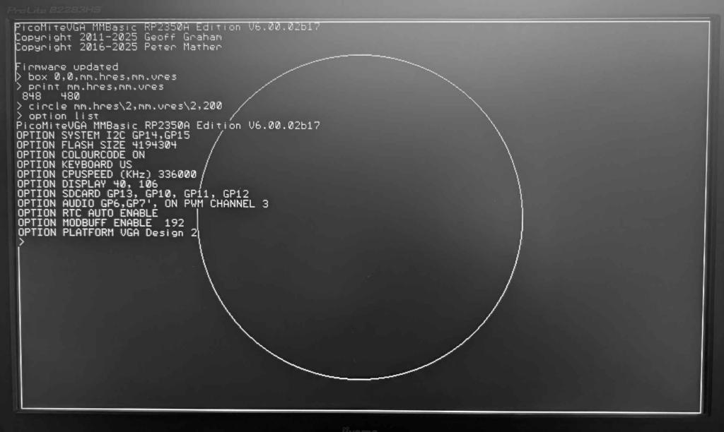

Install the firmware. Type OPTION CPUSPEED 336000. This will switch to 848x480 mode (mode 10 from the CMM2). i.e. true widescreen. You may need to auto-adjust the monitor. Write a box BOX 0,0,MM.HRES,MM.VRES and then do the adjustment.
Please report success or otherwise

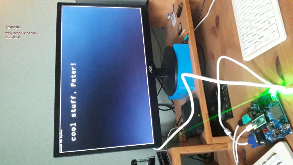

Works perfectly! What a great option to have widescreen!

Tested on Vizio TV and Dell monitor.  The box shows fine after auto-adjust.
For some reason if I add the circle after the box (as in your example) the screen is cleared below the cursor position before the circle is drawn leaving just the top portion of the box.  If I add the box again, the screen is cleared below the cursor position before the box is drawn leaving just the top portion of the circle.
Note that I am testing on a Pico2 mini using Tera Term as that is the RP2350 that I currently have set up for VGA, thus the non-standard VGA pins.
> option cpuspeed 336000
> box 0,0,mm.hres,mm.vres
> circle mm.hres/2,mm.vres/2,200
> option list
PicoMiteVGA MMBasic RP2350A Edition V6.00.02b17
OPTION FLASH SIZE 4194304
OPTION KEYBOARD US
OPTION CPUSPEED (KHz) 336000
OPTION DISPLAY 40, 106
OPTION VGA PINS GP4,GP0

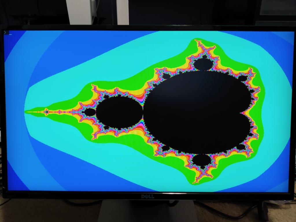

RP2350 VGA WIDESCREEN MODE 3 (848x480) on a 24" (61cm) Dell Widescreen monitor.

Woah! This looks amazing!
Really really useful those new resolutions, since there are less 4:3 nowadays...
