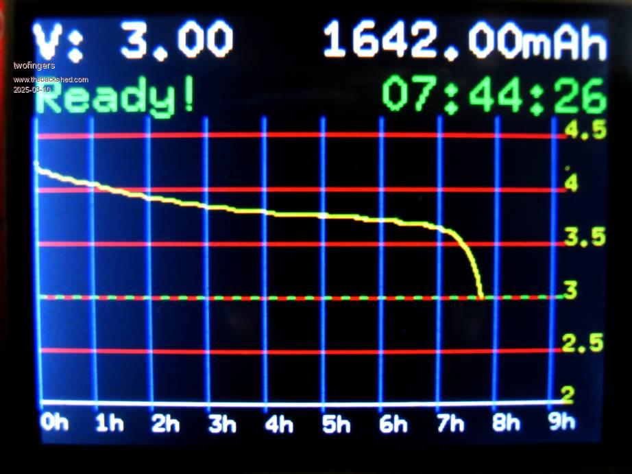

Actually, you only need a Picomite, a logic-level N-MOSFET (like IRL540), a load resistor approx. 18 ohm/1W, 2 * 470k as a voltage divider, 1x 100k and 1x 100nF.

That can work. But I think all you need is a suitable resistor and measurements every second and a shutdown at the threshold voltage. I built a device for measuring capacitance with MicroMites 9 years ago.

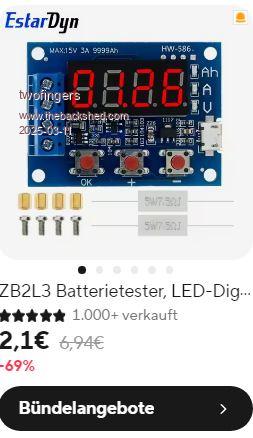

The small 2 EUR zb2l3 modules also work in a similar way. I have been measuring my 36V e-bike batteries according to the same principle for many years. You should check your statements.
As I said, I suspect a misunderstanding.

I wrote above:
  Quote  Actually, you only need a Picomite, a logic-level N-MOSFET (like IRL540), a load resistor approx. 18 ohm/1W, 2 * 470k as a voltage divider, 1x 100k and 1x 100nF.

As long as the resistor is a constant value (we are not measuring the resistance) it is absolutely usable as an accurate sink.
We know the voltage at any time (that is what we measure), so we also know the discharge current (ohms law). So with every measurement we discharge the battery with a known quantity (not the same all the time, but known value), so we can calculate accurately what the cells capacity is. It may take 7 hours, or 8, or 10... doesnt matter. We know exactly the capacity...
twofingers project
Edited 2025-03-10 23:41 by Volhout

  Volhout said  twofingers project
Thank you for providing that link. I think that's what I need.

I use one of these less than £10 on Ebay it'll give you A, W, Ahr, Whr, voltage, if you are measuring a low voltage, like a single lithium, it has a 3pin connection on the side to power it, otherwise it will power itself from whatever you are measuring, you still need a load and to keep an eye on it to prevent over discharge, but otherwise it works great. I just use a relatively powerful LED torch as a load. Remember the faster you discharge the lower the capacity, the usual standard is to arrange a discharge over about 10 or 20 hrs 10c or 20c, but otherwise as long as you don't discharge too fast say a few hours, it'll give you a good idea. I primarily use it to test old laptop cells.
Regards Kevin
