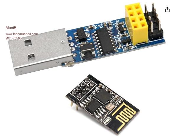

Can anyone tell me which USB/UART code I need to copy to the ESP-01 WiFi module?
I have ordered this module including programmer: ESP-01 Prog WiFi Programmer
Many thanks in advance.

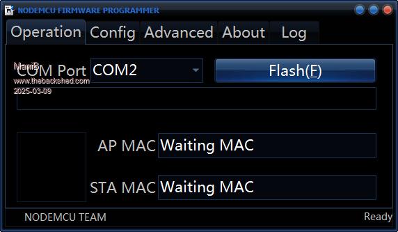

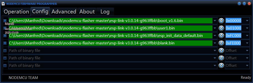

Hello, I wanted to briefly report my current progress.
I am trying to install and set up ESP-LINK on my ESP8266 ESP-01 in order to have a serial to Wi-Fi bridge for my CMM2 G2 V2.
The flashing has now worked using the nodemcu-flasher tool:
https://github.com/nodemcu/nodemcu-flasher/blob/master/Win64/Release/ESP8266Flasher.exe
The esp-link files are available here:
http://s3.voneicken.com/esp-link/esp-link-v3.0.14-g963ffbb.tgz

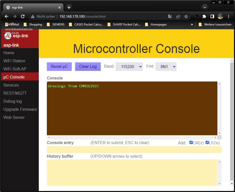

OK, i got it
now I'm able to use COM2 over the air, like:
open "COM2:115200" as 4
print #4 "Greetings from CMM2G2V2!"

1. Get the esp-link files, available here:
2. Get the nodemcu-flasher tool:
3. Put the ESP-01 module on the USB programmer and activate the programmer mode
4. Start the nodemcu-flasher tool and make these configuration:

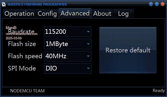

5. Check also the advanced settings
6. Start flashing

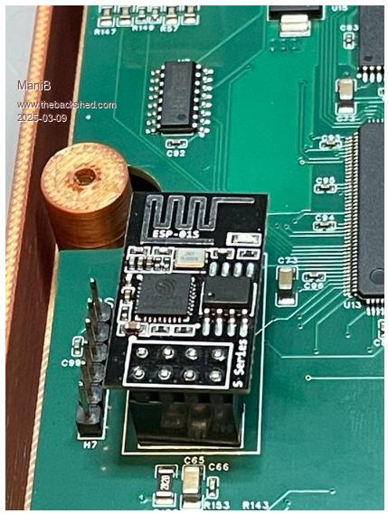

7. After flashing is complete, disconnect the ESP-01 module and put it in your CMM2 G2
8. Turn on your CMM2 G2, take your smartphone to establish a Wi-Fi connection with the ESP-01.
9. You can then open the web page http://192.168.4.1 in the browser to carry out the actual configuration: WiFi station, STA+AP mode, WLAN to which the ESP-01 should connect and the WLAN password.
10. The ESP-01 then connects to the WLAN and is assigned its own IP address (e.g. 192.168.178.100).
With the browser on your PC, this new IP address can be opened with http://192.168.178.100/home.html to make further settings.
