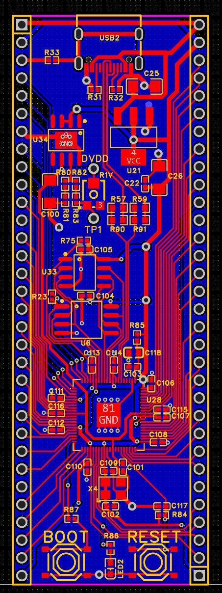

These boards can now be made by JLC who have stock of the RP2350B processors. The boards include positions for the APS6404L-3SQR-SN PSRAM chips but these are currently out of stock at JLC. See the link for the ones I purchased. They are SOP8 packages so easy enough to hand solder.
V1.1 is the board I have just had made
V1.2 is a cut down board designed to minimise costs (costed at $49 for 5 at JLC)

If using the V1.2 files in this post make sure you untick U34/U25 which are the 32-pin headers as they will install them on the wrong side. UPdate versions posted below
Footnote added 2025-03-01 03:15 by matherp
U35/U36

When I go to order from JLCPCB, after downloading the file and clicking Assembly, it says (in effect) dimensions not given. I scroll up and have nothing for X & Y dimensions. What are they?
Posts: 12055
Posted: 05:07pm 28 Feb 2025
Don't understand works perfectly for me - just tested again. Make sure you untick U35/U36 otherwise they will install the headers on the wrong side - edit them out of the BOM and P+P. I'll post updates when I've done it.
Edited 2025-03-01 03:09 by matherp
Posts: 12055
Posted: 05:12pm 28 Feb 2025
Files updated to remove the headers

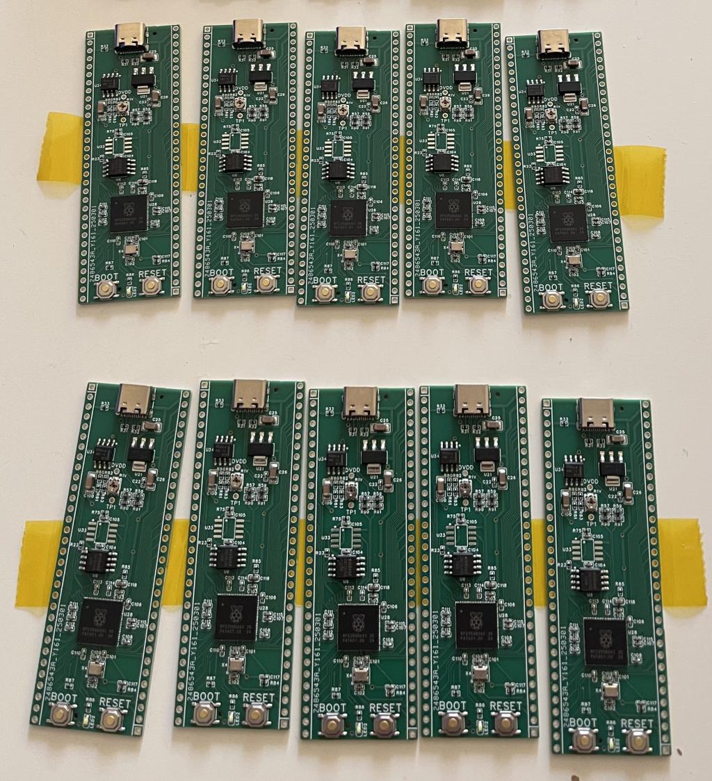

Posted: 07:52pm 28 Feb 2025
I misunderstood and sent the whole original zip file. Have now submitted the 3 relevant files from that file--gerbers, BOM, and pick & place. All successful--though I had to affirm a whole new list of items that I would comply with, including not re-exporting to Russia.

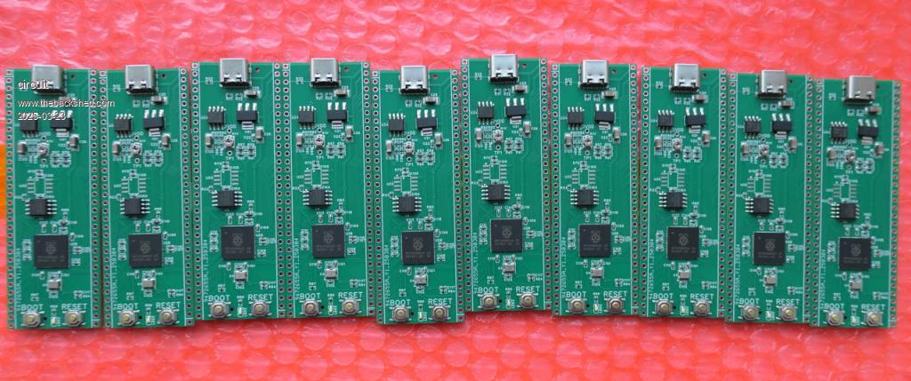

This is to confirm that I have just received the 2350B DIL modules from JLC (they look great Peter!).
Because JLC were out of stock of the PSRAM chips, I ordered genuine parts from Mouser; these arrived yesterday so I have everything needed to begin shipping these out.
For those of you that have been in touch via PM or email, I will start processing your units today with the intention of dispatching by end of tomorrow (Saturday).
For anyone interested, I am selling them at £12 per module as supplied by JLC (plus shipping). As mentioned above, the base module is without the PSRAM chip, and it is also without headers, but I can easily add any of these if required.

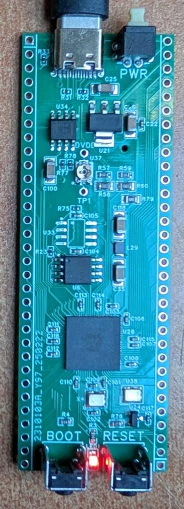

Can I suggest you set the pot before posting. Use a voltmeter between the DVDD test point and GND and set the voltage to 1.3V. This supports 378MHz operation using b16
Posted: 10:59am 07 Mar 2025
  matherp said  Can I suggest you set the pot before posting. Use a voltmeter between the DVDD test point and GND and set the voltage to 1.3V. This supports 378MHz operation using b16
What amazing timing - was just setting it as you were no doubt typing. I set it to 12K and then read your post.....
