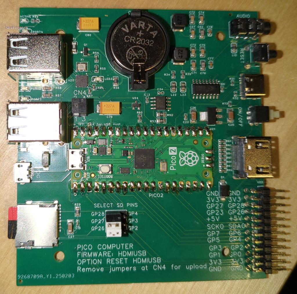

I have received my ordered PicoMite HDMI/USB boards, soldered a Pico 2 onto one of them and everything seems to be working, except for the USB host ports.
At first, I thought my problem could be similar to the one described in this thread https://www.thebackshed.com/forum/ViewTopic.php?FID=16&TID=17703 , but now I don't think it is the same.
I tried to follow the instructions, the HDMI output works, I can see the prompt on the screen, I can access the serial console over the USB-C connector and successfully run the OPTION RESET HDMIUSB on it, the PROG port works fine for flashing, and the SD card can be accessed.
The USB ports for connecting peripherals, however, do not power on even when the jumpers are placed on CN4. The ACTIVE LED in the corner is the only one that lights up on the board. None of the LEDs related to the USB hub controller turn on.
I've measured the correct 3.3V and 5V voltages on the nearest resistors / capacitors to the CH334F, but the PWREN# pin does not go low.
Since according to the schematics, the same connections is used for the PROG port and USB host, I assume that I can exclude the possibility that there is a problem with the solder connection through the holes on the backside.
I have now run out of ideas what to try next. Does anyone have any suggestions?

With the board powered and no USB devices plugged in what LEDs are lit? You should have the red active LED and the green LED3. Make sure the links between 1 to 2 and 3 to 4 are good and the right way round. Post a picture of the board. If active and LED3 are OK then try plugging in a known good simple keyboard. You do have a good powered supply via  the USB-C connector? There have been issues with poor quality cables and/or a weak power source.
Check the orientation of LED3 if not lit - if this is wrong this would cause the issue. With a multimeter in diode mode LED3 should light with the multimeter positive lead at the R56 end.
If all that is OK, check the orientation of X1 and if necessary use a heat gun to reflow U20.

2) Which board do I have exactly:
3) Which LEDs are lit: Only the red "active" LED, but NOT the green LED3
4) Check orientation of LED3: Seems correct, it lights up with multimeter in diode mode and positive lead at R56 end.

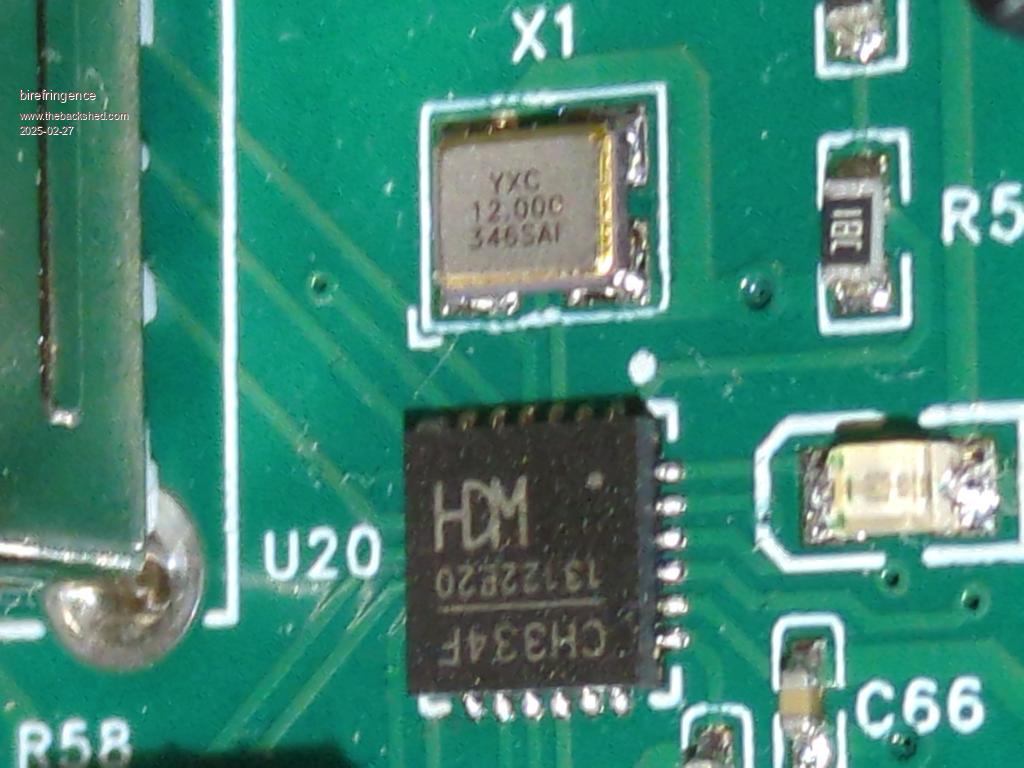

5) Check orientation of X1: Does this look correct?
6) Reflow U20: I will first have to borrow a heat gun for this step.
7) USB-C: I have tried three different power sources and cables, all with the same result.

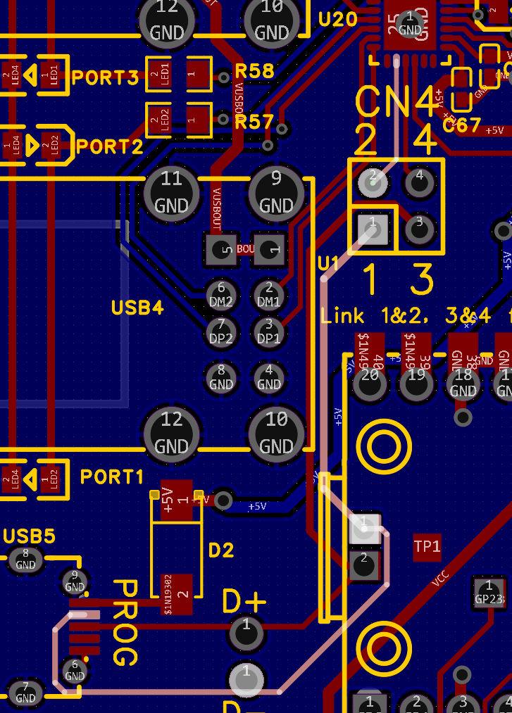

I can simulate your issue by removing the link between 1 and 2 but leaving 3 and 4 in place. I would check the wiring of that line (replace the jumper) and re-do the soldering of the bottom through hole just to be sure.

Looking at the photo of X1 I'm not absolutely certain. Has it got a dot or other indication on the package that's aligned with the orientation mark on the pcb? It's not all that clear (to me anyway) and the dot might be at the opposite corner. I haven't got one of these boards so I've nothing to compare.

The markings and orientation of U20 and X1 match my working boards although the batch/date number are slightly different.
Not sure what to think about all this.  I think the main bases have been covered, power supply, firmware version, solder connections etc.  I built 4 of these boards and shipped one to a fellow shedder who soldered his own Pico2 module.  Other than a bit of extra care soldering the backside connections it was very straightforward.  Either JLC has got a bad batch of parts, or there must be something different about your setup that you haven't discovered yet?

If I connect the PROG port (with jumpers at CN4 removed) to an external powered USB hub, should that work? (it does not seem to be the case)
Should this work, or will D2 prevent the hub detecting the board as an upstream USB port?
