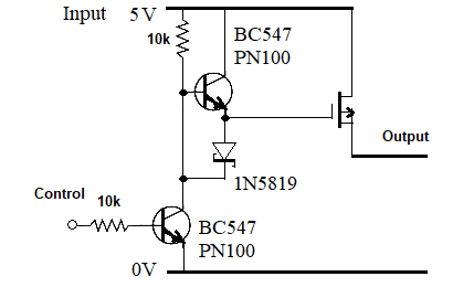

Posts: 3416
Posted: 12:47pm 07 Aug 2025
For faster switching use an active pullup to switch the P-channel MOSFET off.
Edit. I messed up the MOSFET symbol but you get the idea.
Edited 2025-08-07 22:49 by phil99
Posts: 9238
Posted: 03:19pm 07 Aug 2025
Good idea, especially for a bigger mosfet. A bit of overkill for 800pF of gate capacitance though IMHO. :)
