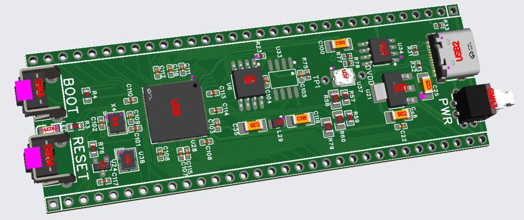

Before incorporating into more complex boards I thought it would make sense to do something to prove the design first. I'm using some different techniques from the Pico design guide but I think/hope they are better and should be more stable (overclockable). Not routed yet but would this be a useful form factor? Ignore the fact the headers are showing upside down. 64-pin 1" between rows

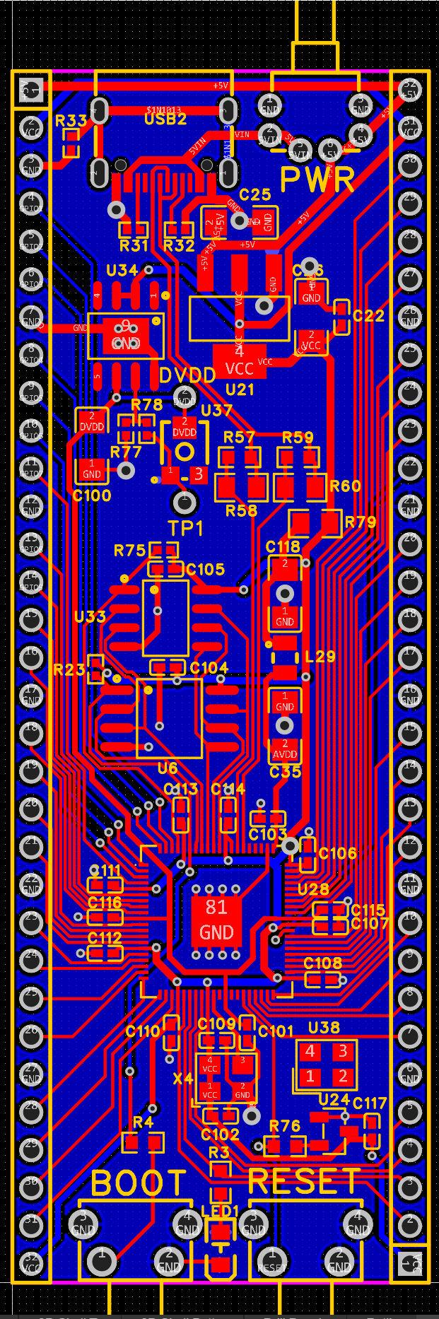

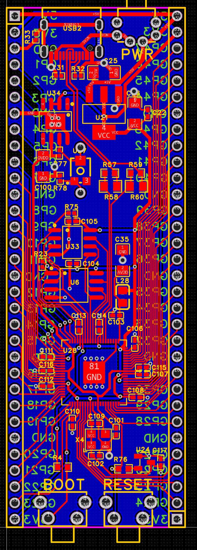

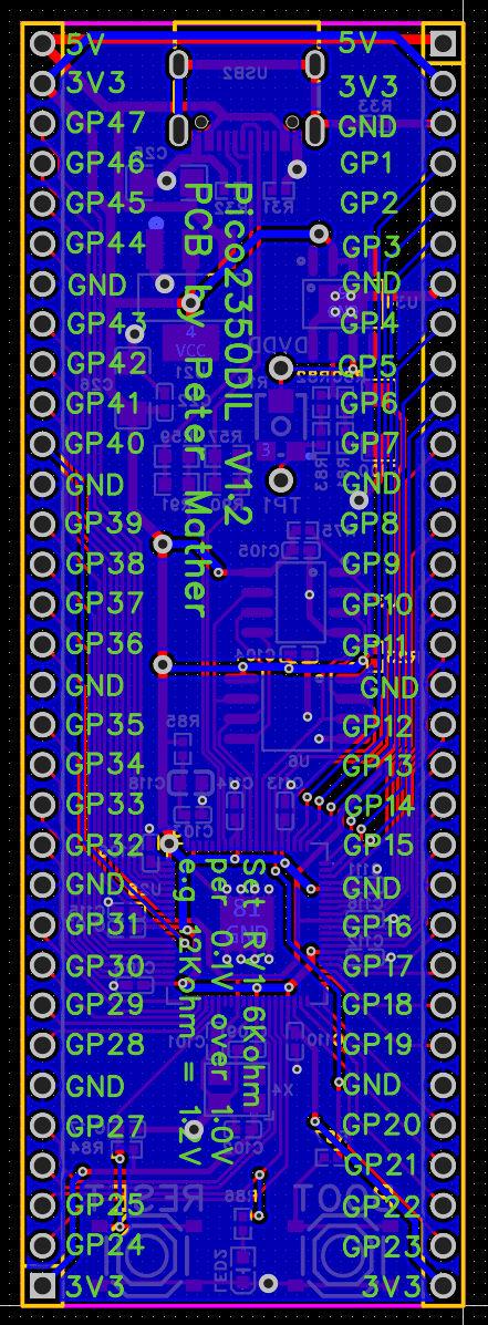

Here is the routed layout. Now I just need to persuade JLC to build it. At the moment they require you to use a specific crystal and inductor to meet the Raspberry Pi design guide but I don't want to do it that way. Worst case I will have to put them on the board unwired

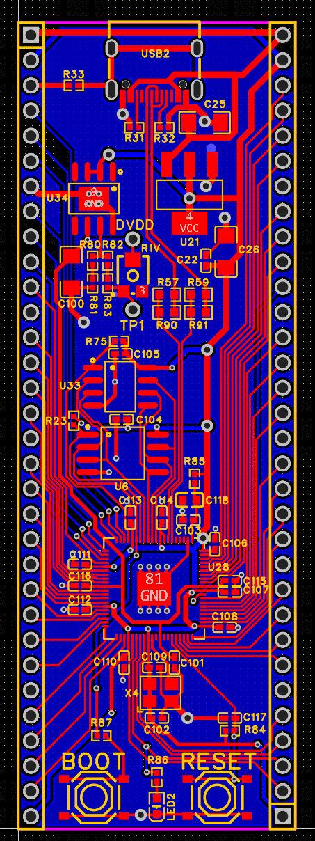

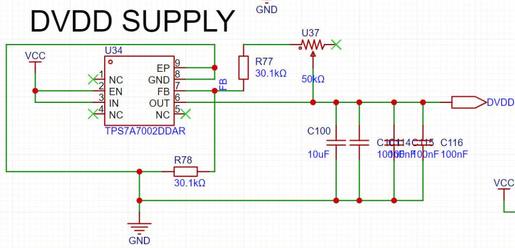

Here is the final version - now includes a heartbeat LED. I've ordered 5 so hopefully no errors. JLC don't have stock of the PSRAM chip (APS6404L-3SQR-SN)
so I've ordered those separately. SOP8 so easy enough to hand solder.
The two test points allow you to measure and set the variable resistor which controls the DVDD voltage. Set to 0 for 1V, 12.1K for 1.2V, 30.3K for 1.5V and if you really want to cook the chip 48.6K for 1.8V.

Maybe i cannot find them but i miss pinouts for reset and bootsel.
And it would be nice to make the psram cs configurable through solder pads or so.

  Quote   i miss pinouts for reset and bootsel.
Perhaps solder wires to the underside of the switches, or if using external switches replace the switches on the board with pins.

@Peter,

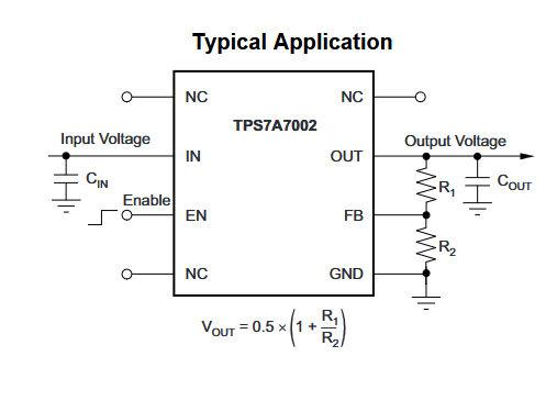

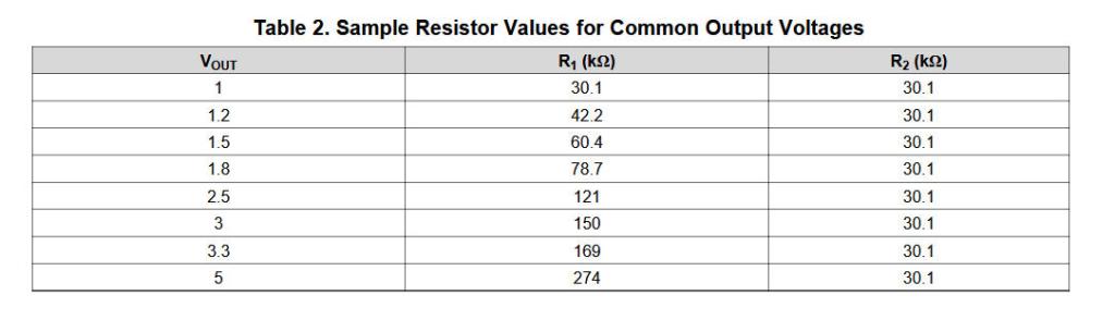

Just querying the pot position to drive DVDD. According to the datasheet, your max voltage out is 1v. Should it be alongside R77 as opposed to R78?
Vout= 0.5x(R77/R78)
Just checking
Edited 2025-02-22 19:35 by WhiteWizzard
Posts: 11785
Posted: 10:37am 22 Feb 2025
Think its correct. R78 is R2, R77+U37 is R1

It allows a deal of healthy over-volting. :) 1V to around 1V8 when the spec says 1V21 absolute max. I won't argue with that. They are allowing for 85C case temperature. :)

A minor refinement may be to tie the free end of the trimmer to the wiper. In the event of the wiper contact point going open it will limit the voltage to 1.8V.
As it is now it will try to rise to Vin.
I don't know how fussy the regulator is to the value of the lower leg resistor but if the trimmer were in that leg the output would drop if the trimmer went open.
Posts: 2991
Posted: 11:38am 22 Feb 2025
  matherp said  Think its correct. R78 is R2, R77+U37 is R1
Yes, this is correct (I was purely going on your pdf schematic that show R77 by itself (and the pot with R78).

Both good points. R2 should be kept between 27K and 33K according to the spec.
