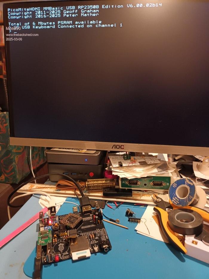

Posted: 10:24am 06 Mar 2025
Hmmmm.....  :(

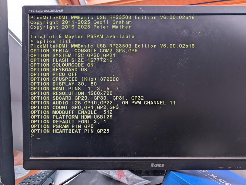

This project seems to have come to a sudden stop. I attempted to test HDMI at 1280 and, in spite of clearing the flash (I think), it seems to be bricked now. Even the console isn't working.
May that be a warning to you all - the PGA2350 mustn't be pushed!
I'll try a bit further but no promises. I'm unwilling to shell out for another PGA2350 at the moment, if at all.
Edit:
It's back but there is definite weirdness with HDMI. Mind you, I don't fully trust this monitor with HDMI. It's shown problems with the PicoMite version in the past and is very poor at switching between normal HDMI and the PicoMite version, taking a while to re-synch. I'm currently testing with 640, 252000 to give it the best chance.
Edited 2025-03-06 21:27 by Mixtel90

Posts: 9081
Posted: 11:29am 06 Mar 2025
I've just done more or less that - going back to the original firmware (b14). You may have a point!
Posts: 11785
Posted: 11:41am 06 Mar 2025
Try this at 1280
PicoMiteHDMIUSBV6.00.02b16.zip
Edited 2025-03-06 21:42 by matherp
Posts: 9081
Posted: 12:24pm 06 Mar 2025
I've not managed to get it to run yet. In fact, it took a couple of reinstall attempts to get it back out of brick mode and back to b14.
I'll have another try now it's running again. :)
Posts: 9081
Posted: 12:37pm 06 Mar 2025
Nope. Nothing, not even the console. I tried wiping the flash first too. It will go back to b14 though!

Posts: 11785
Posted: 12:42pm 06 Mar 2025
Works perfectly on my 64-pin DIL board

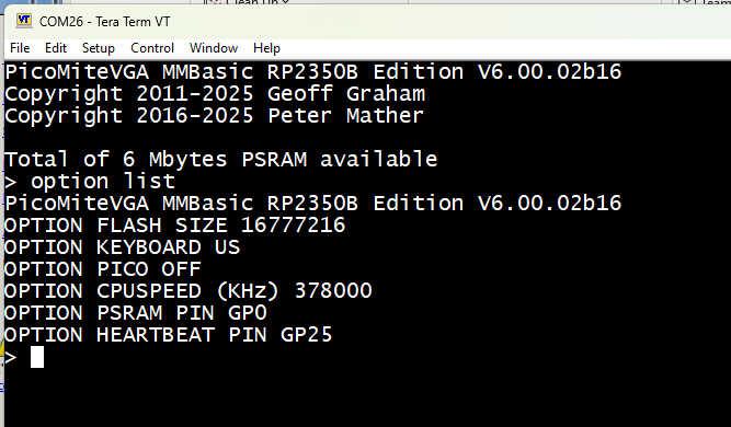

Posts: 11785
Posted: 12:56pm 06 Mar 2025
Full speed vga too...
