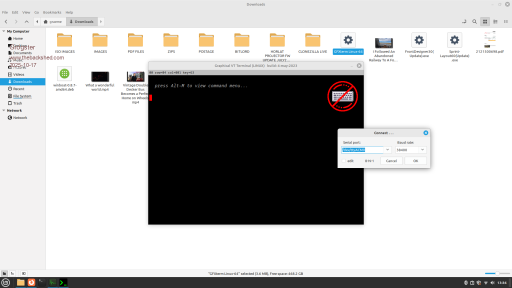

Posted: 11:57pm 16 Oct 2025
As I am playing with Linux again now, I was able to easily download the .deb package, tick "Allow running as executable" in the properties, then just double-click and it ran no problems.
Found a WS Zero module loaded with MMBASIC as the common /dev/ttyACM0 via the drop-down list in CONNECT.
Easy peazy.
