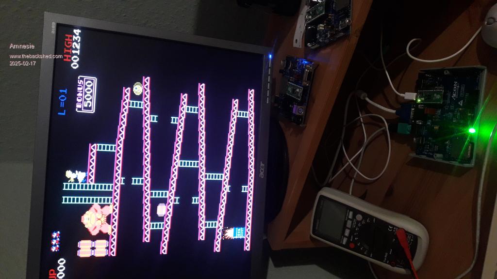

Amnesie
Joined: 30/06/2020
Posts: 763
Posted: 12:10pm 17 Feb 2025
Martin,
I am using the normal default modbuffer settings (no number specified) and have no problems with the latest beta version. So I can't replicate the "heap error"... Hm!
EDIT (!) I see you use "PicoMiteVGA MMBasic RP2040 Edition V6.00.01"
I tested only on Pico 2 board, no problems!
Greetings
Edited 2025-02-17 22:11 by Amnesie

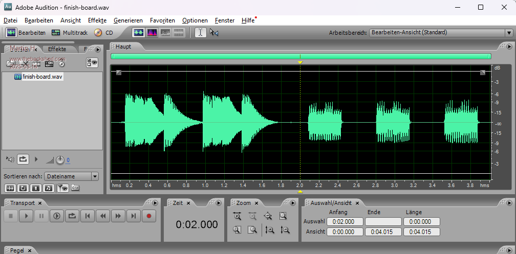

If FLAC makes problems on Pico2, maybe it helps if the Flacs might be converted to 16khz Mono mp3.
but I couldn't test that on 2040 and my pico 2 does not yet have audio.
'no comment
Posts: 6197
Posted: 05:04pm 17 Feb 2025
The 2040 cannot do mp3. The only other option is MOD or WAV. But WAV could also be a problem.
But maybe it is simply stopping audio, and waiting a bit for buffers to clear, and then play flac?
Edited 2025-02-18 03:05 by Volhout
