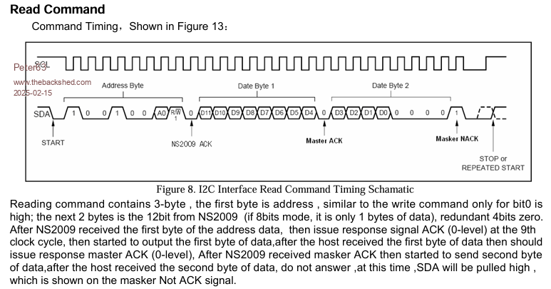

Here is the C program I'm trying to translate into mmBasic code
I want to be able to read x and y position from NS2009 in MMBasic

Posts: 9081
Posted: 04:15pm 15 Feb 2025
Why convert the C code at all?
Just off the top of my head. I can't test this and it probably won't work for one reason or another. In particular you will probably need a delay after each read to allow it to complete before you can manipulate anything. This example is using 100kHz and a 100ms timeout with no error trapping.
Variables on the Pico are 64 bit, so you can read an 8-bit value and shift it up by eight bits then add another 8-bit value. The lowest four bits of the second value are &b0000 so you can then shift the entire value down by four bits. You are left with a 12 bit value.
I'm definitely not saying this will work, I'm no programmer I'm a hardware guy, but it seems more logical to investigate what MMBasic can do alone before attempting to recode C.

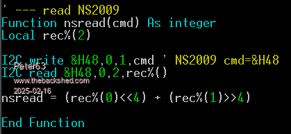

Posts: 6580
Posted: 09:25pm 15 Feb 2025
Assuming
option base 0
and I2C is opened at the start of the program and closed at the end
FUNCTION nsread(cmd) AS INTEGER
 LOCAL rec%(2)
 I2C WRITE &H48,0,1,cmd
 I2C READ &H48,0,2,rec%()
 nsread = (rec%(0)<<4) + (rec%(1)>>4)
END FUNCTION
Peter63
Joined: 28/07/2017
Location: Sweden
Posts: 205
Posted: 12:57am 16 Feb 2025
Reading from NS2009 now works / thanks Jim
/Peter63

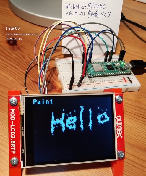

Posted: 03:11pm 17 Feb 2025
' Test program to read from NS2009
' 4-Wire Touch Screen Controller with I2C Interface

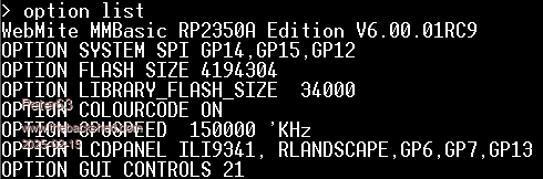

' using WebMite MMBasic RP2350A Edition V6.00.01RC9
CLS
Font 3
Text 0,0,"Paint"
SetPin GP0,GP1,I2C ' set I/O pins for I2C
screen_x_pixel = 320 ' 320
screen_y_pixel = 240 ' 240
Dim x As integer
Dim y As integer
Dim z As integer
I2C open 100,5000
z=nsread(HE0) ' read press-value
If z > 150 Then
 x=nsread(&HC0) ' read x-pos
 y=nsread(&HD0) ' read y-pos
 ' landscape mode screen_pixel flipped
 xx = Int(x * screen_y_pixel / 4096)
 yy = Int(y * screen_y_pixel / 4096)
 Circle yy,xx,2,1
End If
Loop Until Inkey$<>""
I2C close
End
' --- read NS2009
Function nsread(cmd) As integer
Local rec%(2)
I2C write &H48,0,1,cmd ' &H48 = address NS2009
I2C read &H48,0,2,rec%()
End Function
/Peter63
