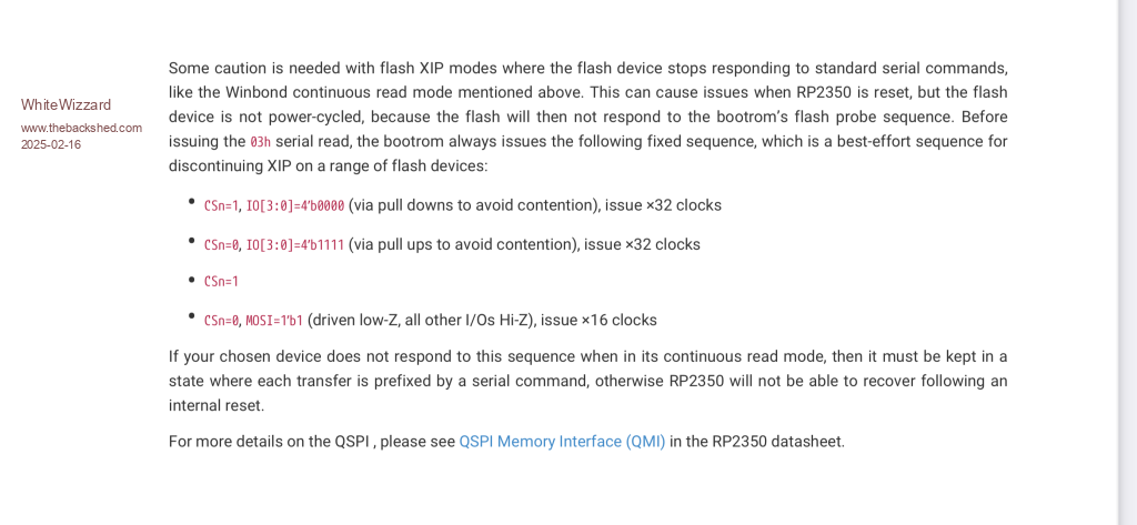

The specific FLASH chip possibly seems to play a part in things. See photo below that relates to this (taken from the RPI 2350 datasheet).
Another thing I’ve read is where the silicon is cut from the disc (electrical tolerances published versus actual tolerances).
I currently have a Pimoroni Pico Plus 2 (ie RP235B) working flawlessly, but a Pimoroni PGA module with identical circuit & parts apart from the 3V3 reg (600mA vs 300mA) which will not work at 1024 or 1280. Default cpuspeed at 640 is 315000 and is stable.
Will order more Pimoroni Pico Plus 2 modules from different sources and see whether they all work (hoping) OR if some will and some won’t.
IF they all work, then will use this as a base circuit on a custom PCB to expose all GPIOs.
If ANYONE out there has got the Pimoroni PGA working at 1024 and /or 1280 then please share info.
